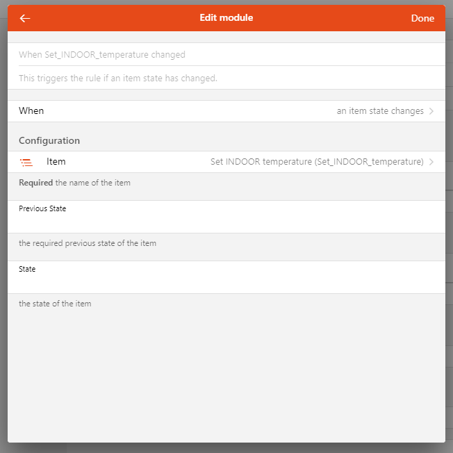

Task: create a rule in which the comparison occurs with the temperature value specified through the settings functionality.
For this purpose, i created and configured a new item “dimmer”, which i applied in the block-scheme already tested above.
Result: the rule works only in Run Now mode, and not in IDLE-state
:thinking:
I apologize, i found my mistake :upside_down_face:
in the new rule for “When” i specified an incorrect item - instead of a temperature sensor i used a temperature setting regulator.
I made the corrections and everything worked correctly

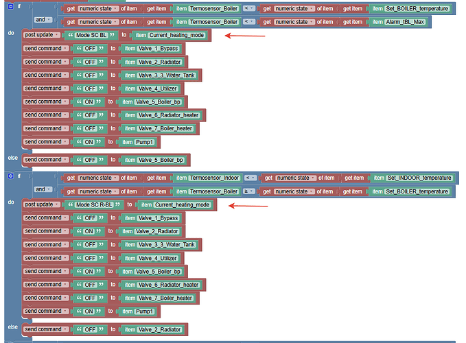

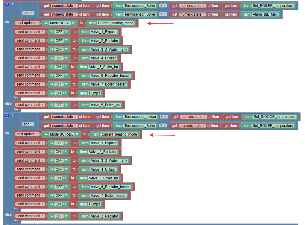

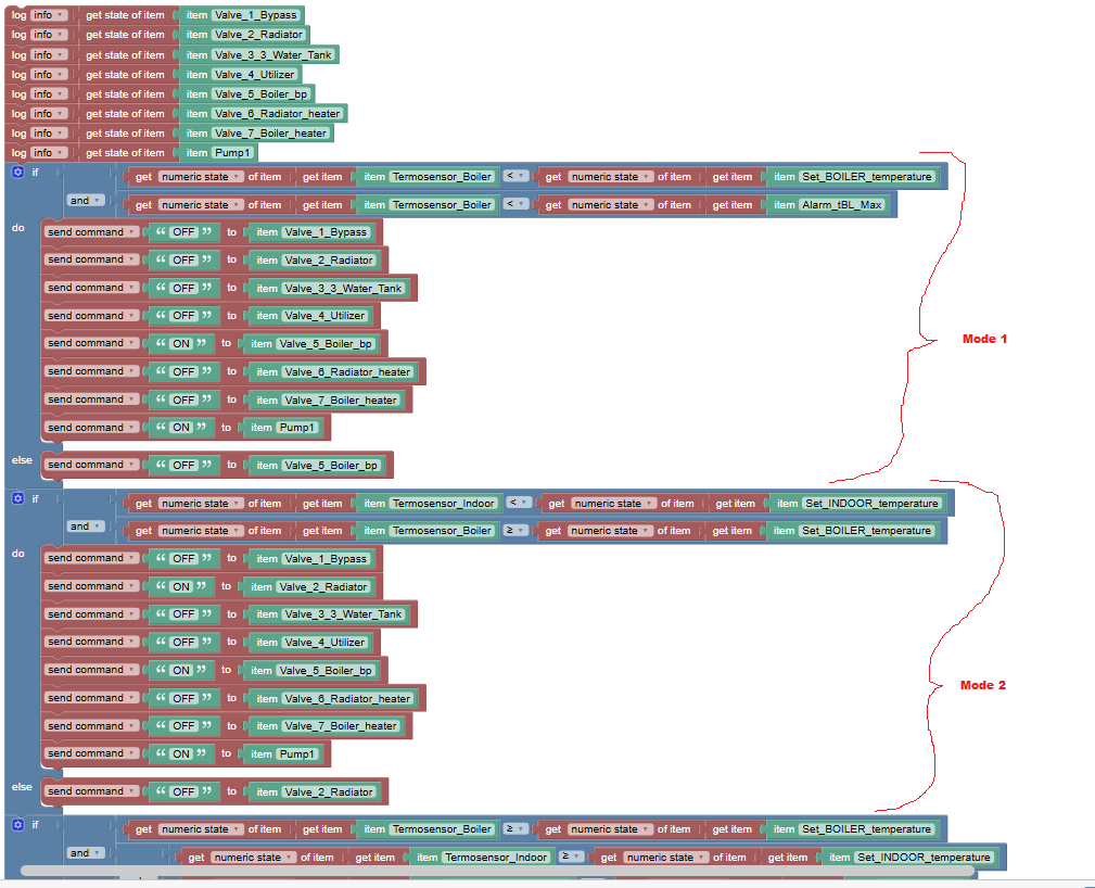

Attached is a screenshot of part of my Blockly rule, in which i have marked two logic scenarios (Mode 1, Mode 2).
Question - how is it possible in Blockly to pass information about the currently running scenario to the item i need?
I’m not sure I understand the question. To “pass information to an item” one either uses postUpdate or sendCommand. You have several blocks that send command here. Are you talking about something else?
…i think you gave me a great hint! :+1:
I’m delighted!
With your help, i made a functionality for informing about which scenario is being executed in real time:
  • made an item, to which information about the scenario from the Rule is transferred. I set the item to auto-update mode (using Metadata).
  • added a post update block with an individual name to the Rule for each scenario
I’m glad you got it working. Since this rule mainly just sends commands to Items are you aware of Scenes?
You can define a Scene for each of your cases under MainUI → Settings → Scenes which is a list of Items and the commands you want to send to those Items. Then in your Blockly rule above, instead of commanding each Item individually, you can call the Scene using the following block:
Leave the context empty and click on the “ruleUID” and select the scene you want to call. That can often be easier to manage than doing so in Blockly code.

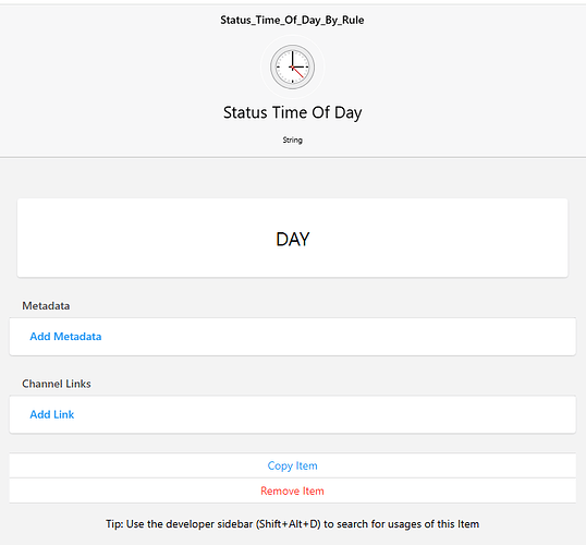

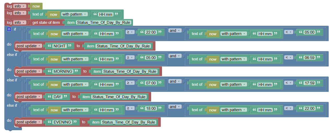

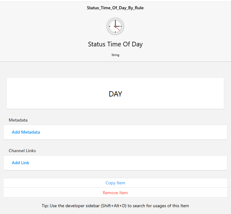

I managed to make the functionality of determining the “Time/part of day” (Night/Morning/Day/Evening) by individual ranges.
I’m not sure that my approach is optimal, but i couldn’t implement it through Time Based State Machine (i simply got confused in the sequence of actions and got stuck on Metadata).
First: created an item of string-type. The status of this item will display the name of the time of day, updated by the Rule, which defines the required parts/fragments of the day, each of which is defined by an individual time range (hours:minutes).
Second: created a Rule that is launched by a trigger (for myself I defined every minute) and a scenario for assigning a name to each part of the day.
Correction of the rule for the NIGHT block:
instead of the AND operator there should be an OR operator
