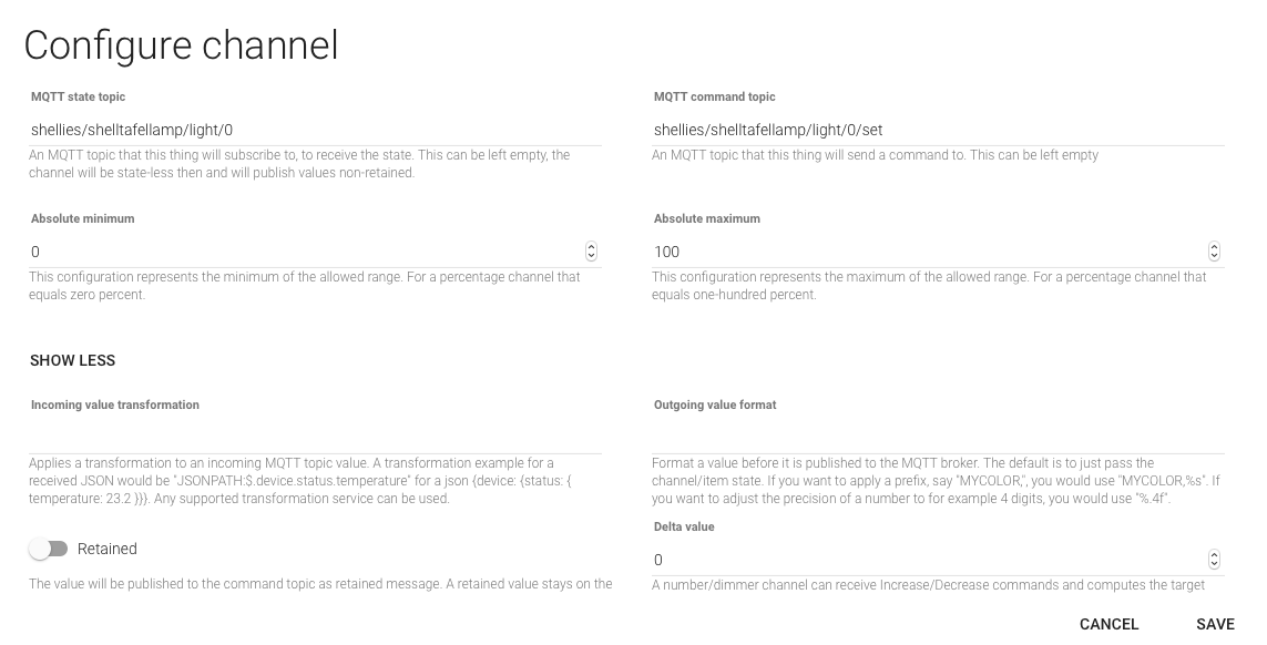

I just installed the new Shelly dimmer, I turned on the MQTT function and configured a generic MQTT device and linked a number channel.
For the power on/off button it works just fine, I used the support page from Shelly to configure it, so the status is: shellies/shelltafellamp/light/0 and for the command prefix: shellies/shelltafellamp/light/0/command
So this is the config in PaperUI at the moment, I feel like I need to fill out the transformation field but can’t figure out what the statement should be…

Thanks, I started playing around a bit with MQTT.fx and with sending some different types of payload.
After some time I figured out that when I use the payload {“turn”: “on”, “brightness”: 100} it wil always set the light at 100% brightness, so I changed the payload to {“turn”: “on”, “brightness”:%s} and that works great, so the dimmer works with a slider on my habpanel.
