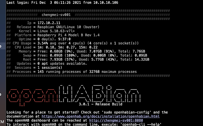

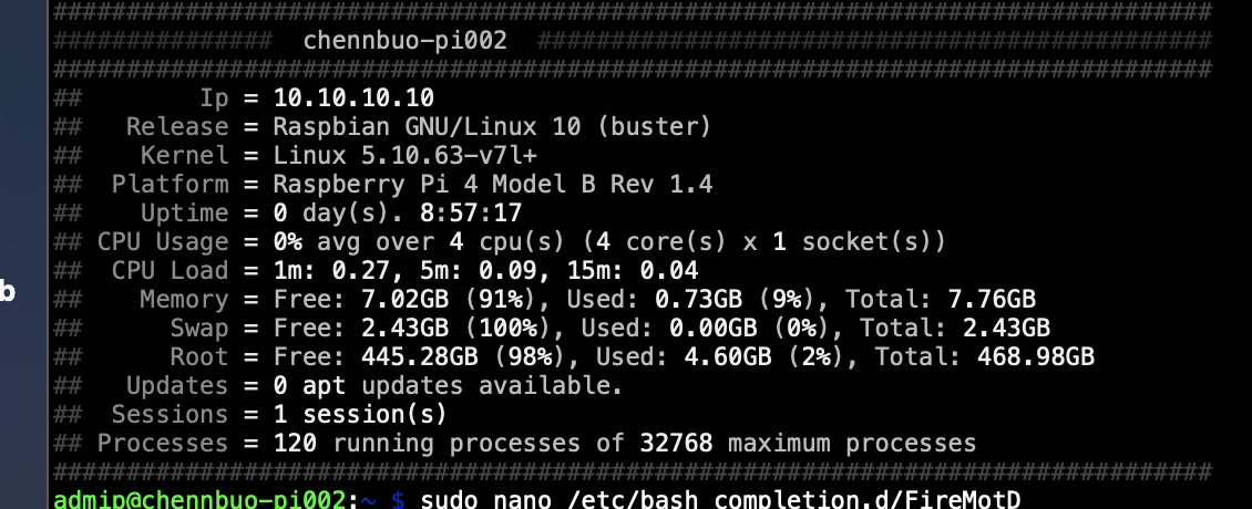

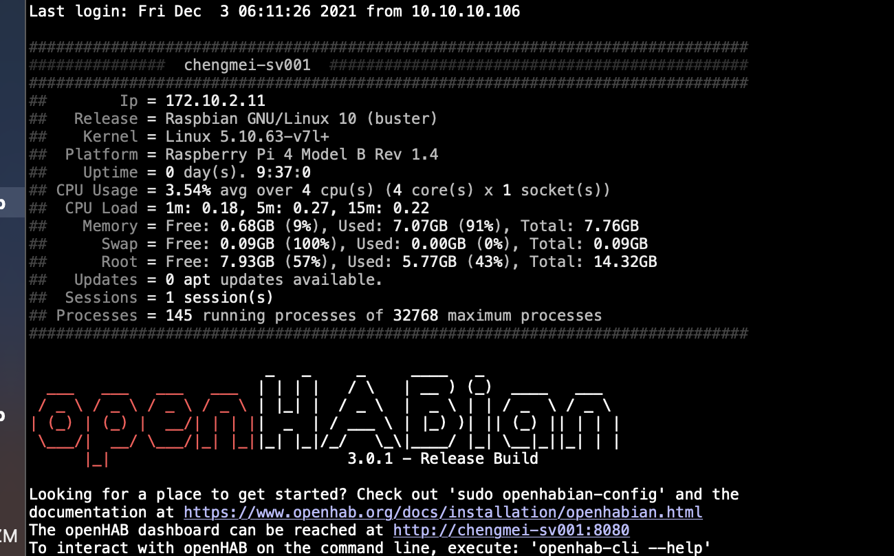

I have two raspbarries in two houses. Now I wanted to build that one. Unfortunately, it doesn’t show me an Openhab banner at one time (see pictures) where is this exactly defined? And how can I change that. Where is the call with SSH Connect?
