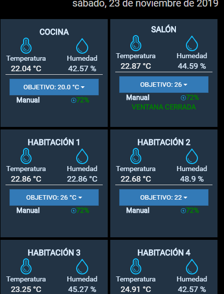

Hello friends. I am creating a new widget that allows me to control for each room:
-Temperature
-Humidity
-Setpoint
-Mode
-Battery
-Open window
I am trying to change the color of the text in which the temperature is displayed so that:
Current temperature> 24 → red color
Current Temp <21-> blue color
Else → white color
For this I am using this sentence, and it does not work.
<div class="row">
  <div class="col-xs-6"><span style="color: {{itemValue(config.temperatura_actual)>24?'red':itemValue(config.temperatura_actual)<21?'blue':'white'}}; font-size: 12pt">{{itemValue(config.temperatura_actual)}}</span></div>
  <div class="col-xs-6"><span style="font-size: 12pt">{{itemValue(config.humedad)}}</span></div>
</div>
Could you give me some hint of how I have to do it.
Thank you.
Those look quite cool. You gonna share when done? :wink:
It looks right. If you print that to screen, what do you get?
If you look at my train times widget in the galley, I do the same thing with delayed trains.
On phone so can’t look atm.
