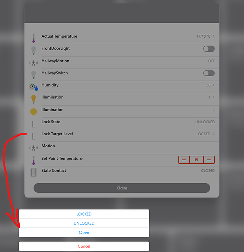

To be more clear i have an example from my door lock
Would someone please be so kind to help me out?
