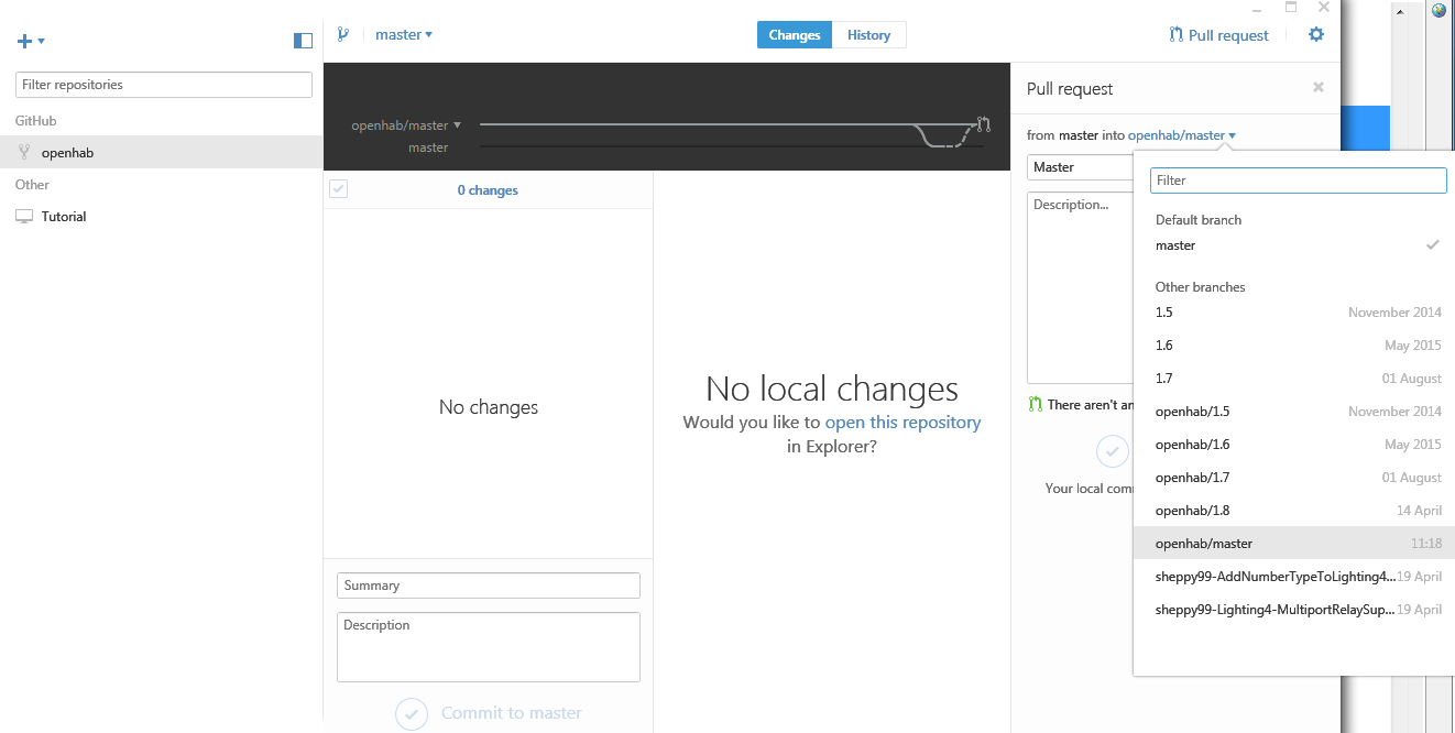

I’ve tried to follow this, and now I have a Git client on my desktop, however I don’t understand what I have to do next and the only thing I can find to squash is a nearby fly - see picture of what I have so far, I’m on Win7 - apologies if this is blindingly obvious!
