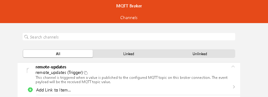

Here is the item definition screenshot:
The broker on this machine only has 1 channel which is a remote update trigger, this machine receives the updates via the MQTT eventbus
