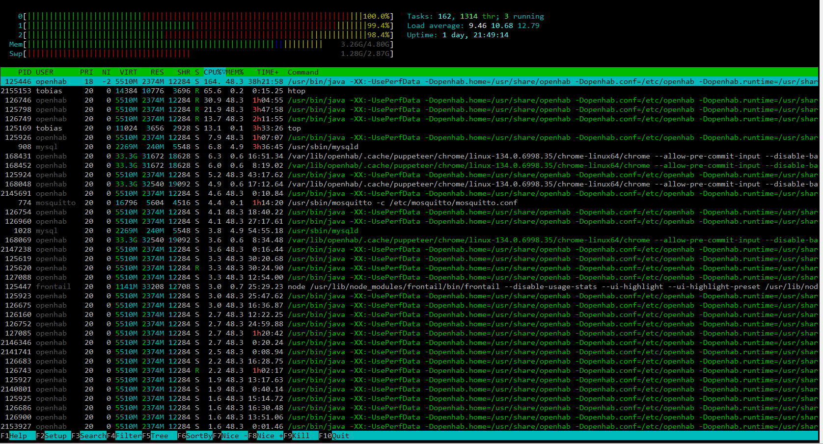

The example is quite extreme, as I was also having overheating issues with the server and the CPU was heavily throttled, but even so, I consistently see a CPU utilization of 3 or higher…

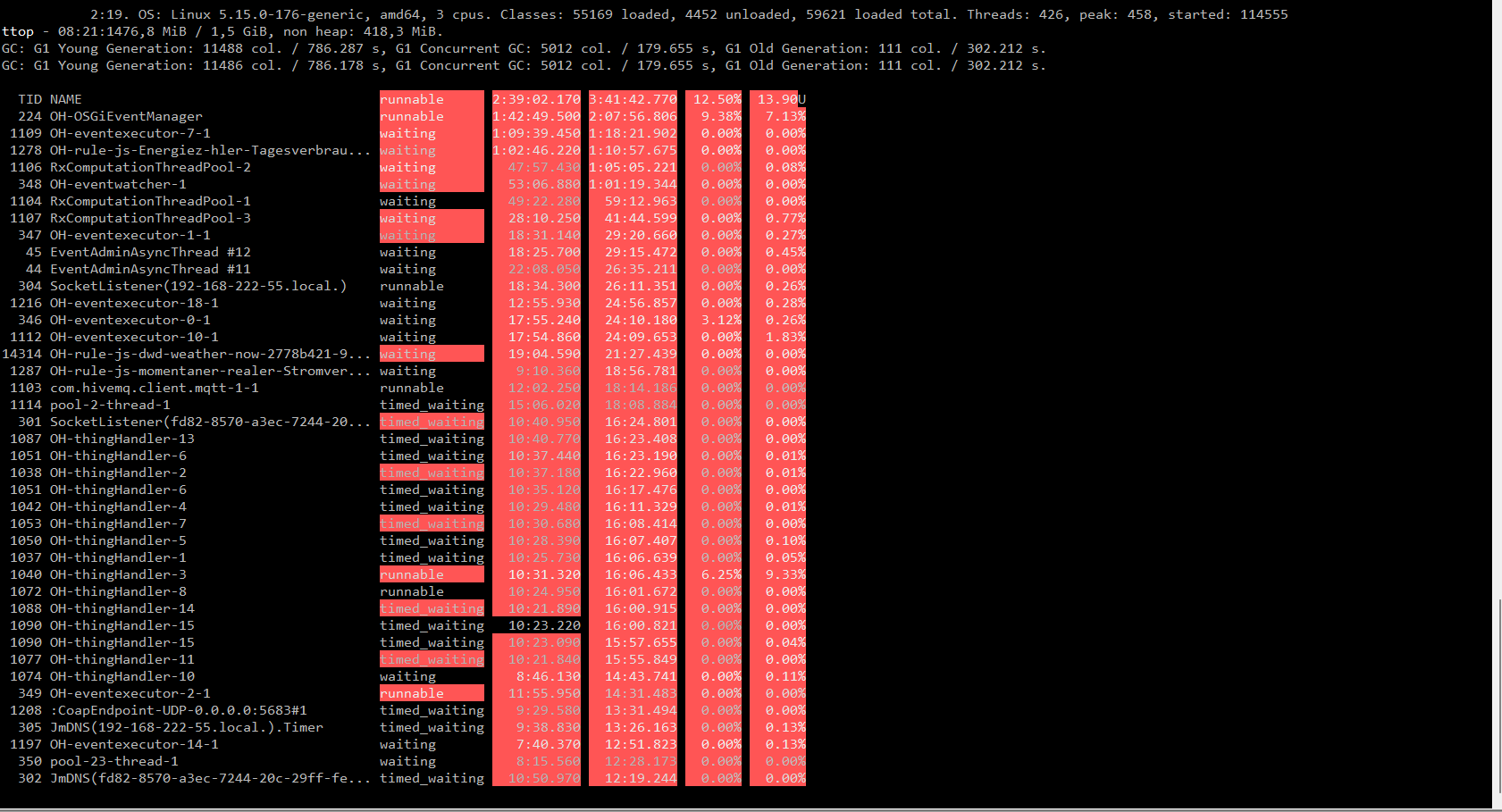

Additionally, I ran a thread dump during the high-load phase, but I don’t really know what to make of it…

With the info presented all I can really say for sure is that openHAB is indeed the one using up the CPU. The top suspect in that thread list is the rule Energiez-hler-Tagesverbrau… There is no reason any rule should be that high up in the list (assuming it’s sorted by CPU usage).
