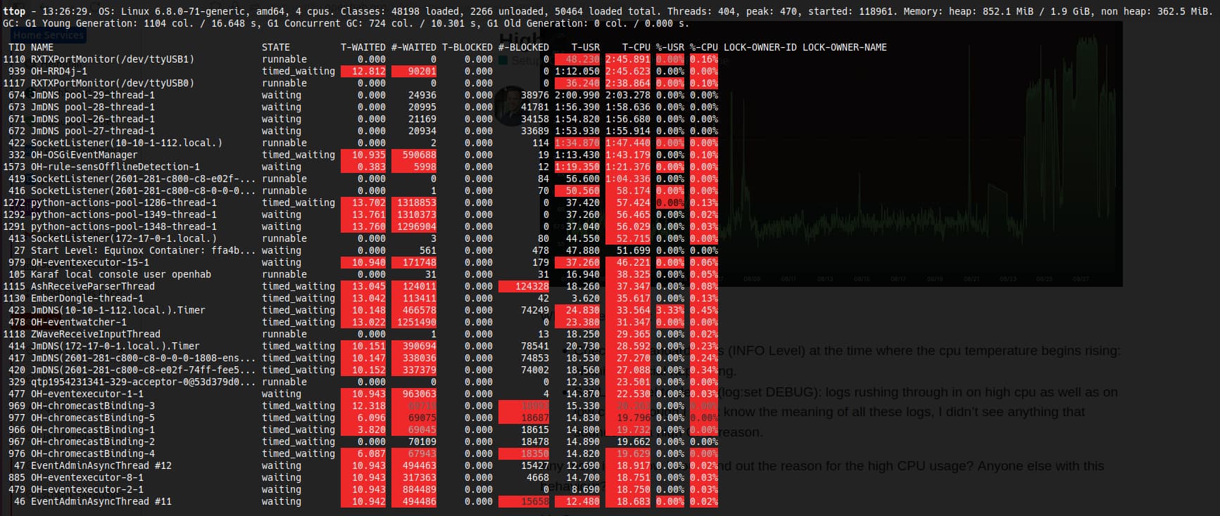

ttop --stats=tid,name,state,waited_time,waited_count,blocked_time,blocked_count,user_time,cpu_time,user_time_perc,cpu_time_perc,lock_owner_id,lock_owner_name --order=cpu_time --millis=300
The threads will be listed in order with those using the CPU the most time at the top. The first entry in the list is the most likely culprit. It will look something like this:

where XXXX is replaces with the thread ID, the number if the first column of the first row in the ttop command. Based on the thread name and stack trace we should be able to identify what it doing. For example, in my screen shot the top CPU user is 1110 and calling threads 1110 shows:
openhab> threads 1110
Thread 1110 RXTXPortMonitor(/dev/ttyUSB1) RUNNABLE
Stacktrace:
gnu.io.RXTXPort.eventLoop line: -2
gnu.io.RXTXPort$MonitorThread.run line: 108
The thread monitoring ttyUSB1 us using the most CPU. That’s the Zigbee coordinator on my system and I’m not too surprised it’s using the most CPU on my system. Yours will probably show a stack trace coming from an add-on or a rule.
