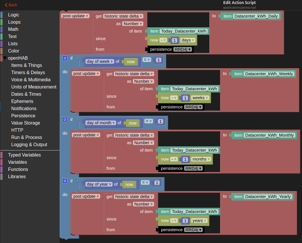

This rule runs every midnight and updates items for daily, weekly, monthly and yearly energy consumption.
Language: JS Scripting
Changelog
Version 0.1.3
  • fixed persistence bug replaced history.deltaSince with persistence.deltaSince
Version 0.1.2
  • fixed more typos
Version 0.1.1
  • fix some typos and wrong placeholders
Version 0.1
  • initial release
Resources
uid: hmerk:historical_energy_consumption
label: Historical energy consumption
description: Updates Items holding information of historical energy consumption
configDescriptions:
  - name: persistenceService
    type: TEXT
    context: text
    label: Persistence Service
    description: Persistence service used to store information
    limitToOptions: true
    options:
      - label: default
        value: default
      - label: RRD4J
        value: rrd4j
      - label: MapDB
        value: mapdb
    required: true
  - name: energyCounter
    type: TEXT
    context: item
    label: Energy Counter Item
    description: Item that represents the energy counter value
    required: true
  - name: energyUsageDaily
    type: TEXT
    context: item
    label: Daily energy consumption Item
    description: Item that represents daily energy consumption
    required: true
  - name: energyUsageWeekly
    type: TEXT
    context: item
    label: Weekly energy consumption Item
    description: Item that represents weekly energy consumption
    required: true
  - name: energyUsageMonthly
    type: TEXT
    context: item
    label: Energy consumption this month
    description: Item that represents monthly energy consumption
    required: true
  - name: energyUsageYearly
    type: TEXT
    context: item
    label: Energy consumption this year
    description: Item that represents yearly energy consumption
    required: true
triggers:
  - id: "1"
    configuration:
      cronExpression: 1 0 0 * * ? *
conditions: []
actions:
  - inputs: {}
    configuration:
      blockSource: <xml xmlns="https://developers.google.com/blockly/xml"><block
        type="oh_event" id="DcoZNq7swfEZoj)0Ua]X" x="-820" y="-416"><field
        name="eventType">postUpdate</field><value name="value"><shadow
        type="text" id="#(yQc8CV:OKPW@[kDmLq"><field
        name="TEXT">value</field></shadow><block type="oh_get_persistvalue"
        id="QcdG@s#+KDDo52O!ai.+"><field
        name="methodName">deltaSince</field><value name="itemName"><shadow
        type="oh_item" id="Py}?{~?.icb-QZU-}e|%"><mutation itemName="MyItem"
        itemLabel="MyItem"></mutation><field
        name="itemName">MyItem</field></shadow><block type="oh_item"
        id="{c|-MK@dbovJXw#OdoU%"><mutation
        itemName="{{energyCounter}}" itemLabel="Energie
        Counter"></mutation><field
        name="itemName">{{energyCounter}}</field></block></value><value
        name="persistenceName"><shadow type="oh_persistence_dropdown"
        id="a|^dX_MtavSf1=2cxeGW"><field
        name="persistence">default</field></shadow><block
        type="oh_persistence_dropdown" id="u.6YT}kCv9:!jJLX)Ha|"><field
        name="persistence">rrd4j</field></block></value><value
        name="dayInfoSince"><block type="oh_zdt_plusminus"
        id="[bDW~ua-t]1?8nutF9y!"><field name="plusminus">minus</field><field
        name="period">Days</field><value name="offset"><shadow
        type="math_number" id="{sVjuwBlf6dS!(gW*BYk"><field
        name="NUM">0</field></shadow><block type="math_number"
        id="WSiMw);T_W7KBh@4-u_L"><field
        name="NUM">1</field></block></value></block></value></block></value><value
        name="itemName"><shadow type="oh_item"
        id="NPb)7;I@d$=vPq^*MJ)`"><mutation itemName="MyItem"
        id="a8-G;5w)iG|(X+LUPFbs"><mutation
        itemName="{{energyUsageDaily}}" itemLabel="Daily energy
        consumption"></mutation><field
        name="itemName">{{energyUsageDaily}}</field></block></value><next><block
        type="controls_if" id="0?4$NID6H0C9A#:}wuQ!"><value name="IF0"><block
        type="logic_compare" id="U6pYz7%x*I#a`^Y!pGY~"><field
        name="OP">EQ</field><value name="A"><block type="oh_get_zdt_part"
        id="RR$AD9u6D!yHL3_n!WXk"><field
        name="temporalPart">getDayOfWeek</field><value name="zdt"><block
        type="oh_zdt_now"
        id="nYo=K+nRS]V%g#,Pi;t/"></block></value></block></value><value
        name="B"><block type="math_number" id="9%MBAcAkS:LmTC52RXu*"><field
        name="NUM">1</field></block></value></block></value><statement
        name="DO0"><block type="oh_event" id="{8[5EibFv*n^xlsfU_9r"><field
        id="%EWS?a0ed.^2W%u0r/4T"><field
        type="oh_item" id="4~Z=Bm{5152mLS;7$5k}"><mutation itemName="MyItem"
        id="|D|At2K+fPXe#|m]z}MD"><mutation
        Gesamt"></mutation><field
        type="oh_persistence_dropdown" id="O_c{pjiLi0O6(c+/5ug5"><field
        id="y[1(nPz]4`Nk7Kq#pVMS"><field name="plusminus">minus</field><field
        name="period">Weeks</field><value name="offset"><shadow
        type="math_number" id="%ENY;4,LF9~rYdncN*J."><field
        id="n};3a{3CvDCE)8$V]V9%"><field
        id="#fQEeLvX$:+Ok0s-_ndA"><mutation itemName="MyItem"
        id="4TyCQX|zx,QZlhsj[R4d"><mutation
        itemName="{{energyUsageWeekly}}" itemLabel="Weekly energy
        name="itemName">{{energyUsageWeekly}}</field></block></value></block></statement><next><block
        type="controls_if" id="|NWnM*J!|AH9]Zfa[w-m"><value name="IF0"><block
        type="logic_compare" id="[E}0z@95rr_-(^9a##Iq"><field
        id="(hY?hpqJyp,-~lbvVgB]"><field
        name="temporalPart">getDayOfMonth</field><value name="zdt"><block
        type="oh_zdt_now"
        id="(Dm;y)NZo`dU-VwwNI,q"></block></value></block></value><value
        name="B"><block type="math_number" id="i{%ezg~{d;[v`o^#g[L,"><field
        name="DO0"><block type="oh_event" id=",%4=aUR`Dp;lZk[vS=iI"><field
        id="*}wUT?2YIi{%UWLFF)R["><field
        type="oh_item" id="E16,H4)4DqzApG}4|Mrm"><mutation itemName="MyItem"
        id="1u;KZKQ;4ytz0hKJT;/f"><mutation
        type="oh_persistence_dropdown" id="`w~opwkei^7CIB3FrO+."><field
        id="Z?~MSD!-em3!8FSpdz8c"><field name="plusminus">minus</field><field
        name="period">Months</field><value name="offset"><shadow
        type="math_number" id="#+a!N7#(|H6,-X8@ROJU"><field
        id=")^WuCM:FMVt1,K*X5STB"><field
        id="u9c,ktf{y}x6}w%8#jj~"><mutation itemName="MyItem"
        id="Sc9a}rvsYblGZ4/n@Rs]"><mutation
        itemName="{{energyUsageMonthly}}" itemLabel="Monthly energy
        name="itemName">{{energyUsageMonthly}}</field></block></value></block></statement><next><block
        type="controls_if" id="Z|(jQNM~N;sjEs_9,OD,"><value name="IF0"><block
        type="logic_compare" id="~BC$sP`2wv49=P@wbIQl"><field
        id="%X4Q/;r!xG,lPkC3i,~E"><field
        name="temporalPart">getDayOfYear</field><value name="zdt"><block
        type="oh_zdt_now"
        id="1/mF/jsRwX7L}-V/eu8#"></block></value></block></value><value
        name="B"><block type="math_number" id="C8-sV|{33~aWV%c8.]5|"><field
        name="DO0"><block type="oh_event" id="ThuO;#wF9bwNr`GCc#zC"><field
        id="e!g~$Qww)$==?dC|Ph?."><field
        id="#($cP7M_#{wMbxt.#k[b"><mutation
        type="oh_persistence_dropdown" id="3A$FKU5,%6(lF$U]q[Sr"><field
        id="Sy2=fJPU]:hwbCwD+B|Y"><field name="plusminus">minus</field><field
        name="period">Years</field><value name="offset"><shadow
        id="?n62/(a806h70QpkWW+2"><field
        id="?(##OvabvK76gTfk7(Q2"><mutation

Can you please post a screenshot of the blockly part.
Mine is looking like this and working:
BTW, what openHAB version do you use ?
Running 4.2.2, the blockly is cool, never seen that before.

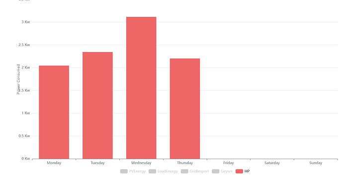

hi there
Thank you for this, I have had this running for a few days. Iam not sure that iam getting numbers correctly. The rule is triggered at 1 sec past midnight and the difference of the last day is posted to the daily value for the new day. As per my graph attached, the figure posted for today thursday is actually for wednesday. Today should actually be zero. Did i miss something or do something wrong?
