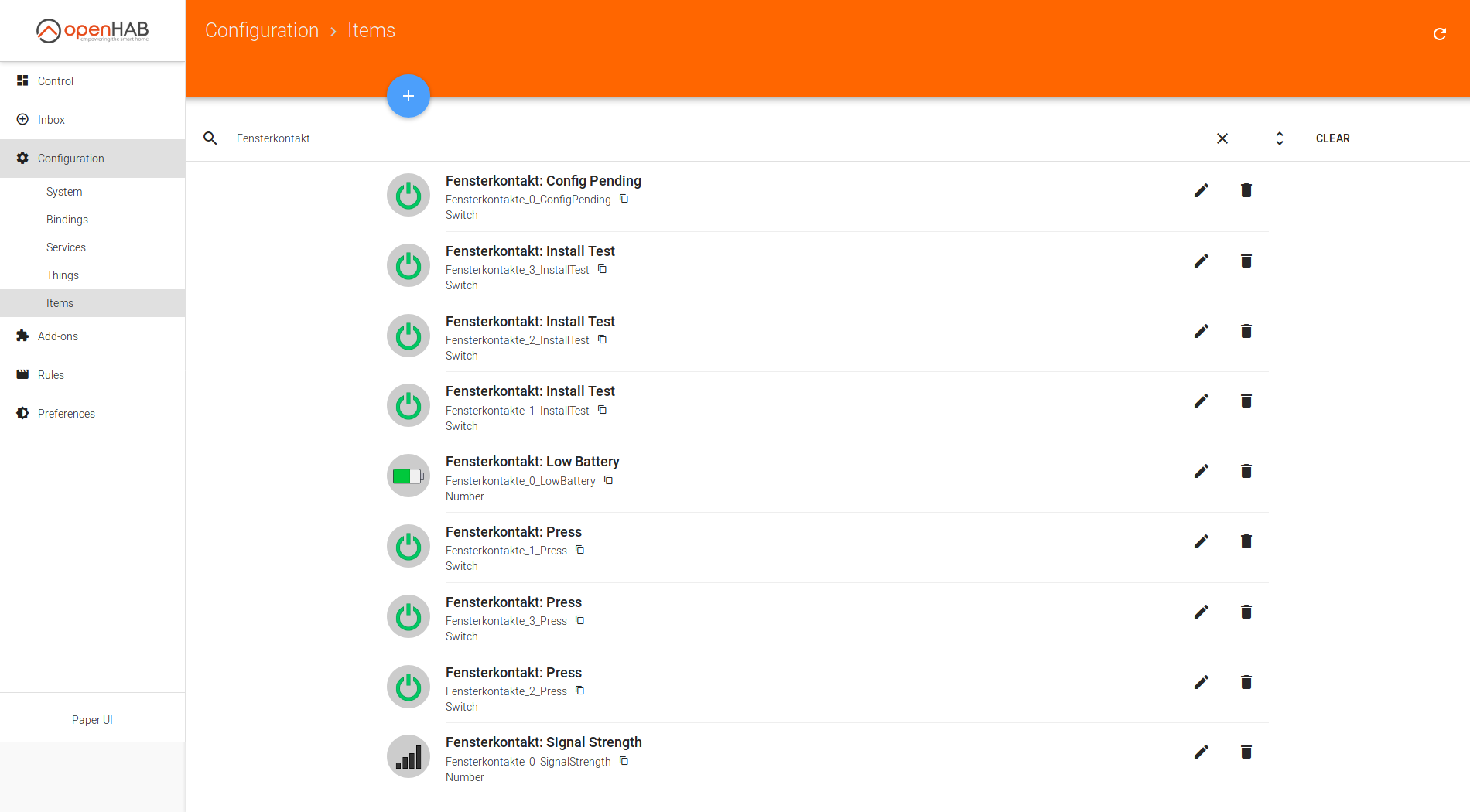

The HM-SwI-3-FM shows up in my PaperUI Inbox providing three Switch-Interfaces ending in #Press. If I connect Pin 1/2/3 to GND (or use my magnetic contacts) no event shows up in the event.log nor in PaperUI.
However, the wiring seems to be correct as I receive a oneshot Update on #Install_Test on the first contact event. But I need to reset it manually to OFF to receive it again on the next connect. Using the Press-Switches does not seem to do anything.
They are set up as switches and show up as such in in the PaperUI. If I press them they immediately switch back to OFF. The corresponding events are shown in the event.log. The actual device does not seem to react to it.

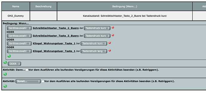

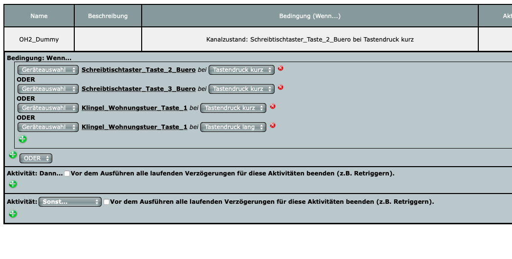

properly detected and configured in the Raspimatic
connected to a DUMMY program to get the sensor events processed correctly in the Raspimatic (like expained above in the thread)
properly configured as thing in openHAB
the channels are properly linked to the related Items
the items show the correct state e.g. for battery or signal strength
