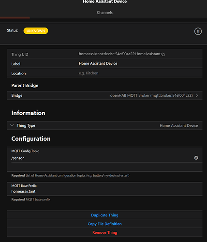

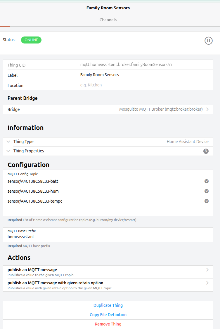

The Home Assistant device in OH looks like this:
If I update the config topic I see this error in the log:
2025-12-25 23:14:48.863 [ERROR] [st.core.internal.thing.ThingResource] - Exception during HTTP PUT request for update config at 'things/homeassistant:device:54ef004c22:HomeAssistant/config'
java.lang.IllegalArgumentException: Bad configuration. topic must be <component>/<objectId> or <component>/<nodeId>/<objectId>!
What do I need to put in the config topic?

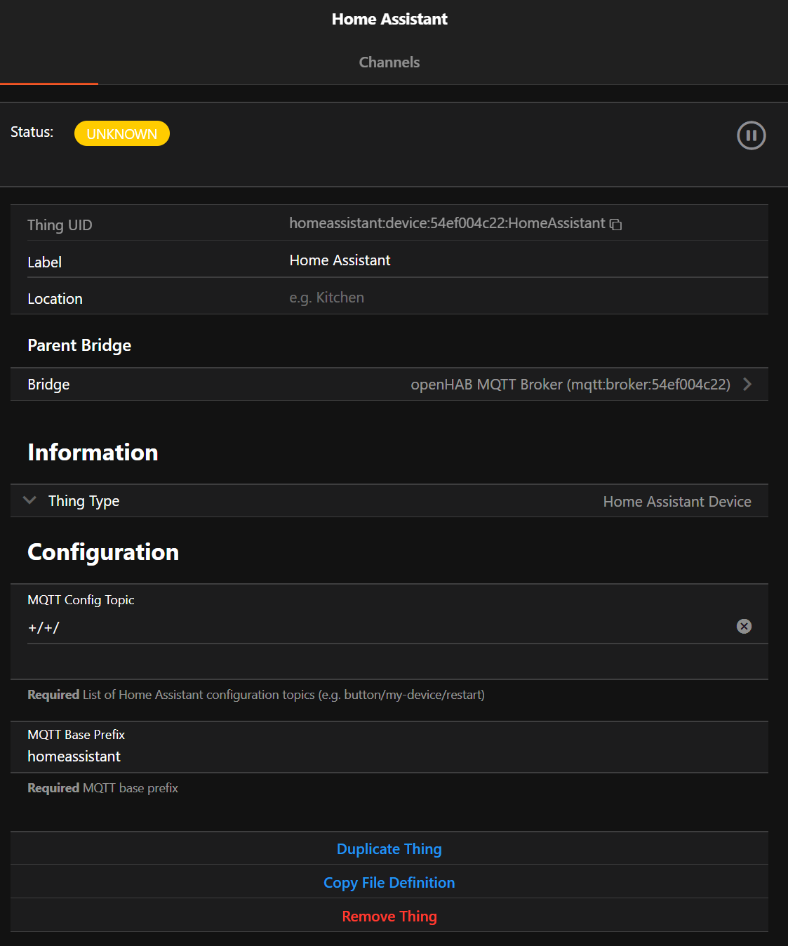

If I click on save on the thing as it was in the screenshot above I get this error:
I tried changing it to:
as per the suggestion from @krishgcek but that results in “Unknown” as the thing error message:

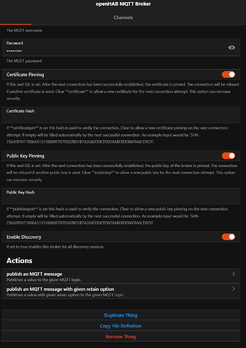

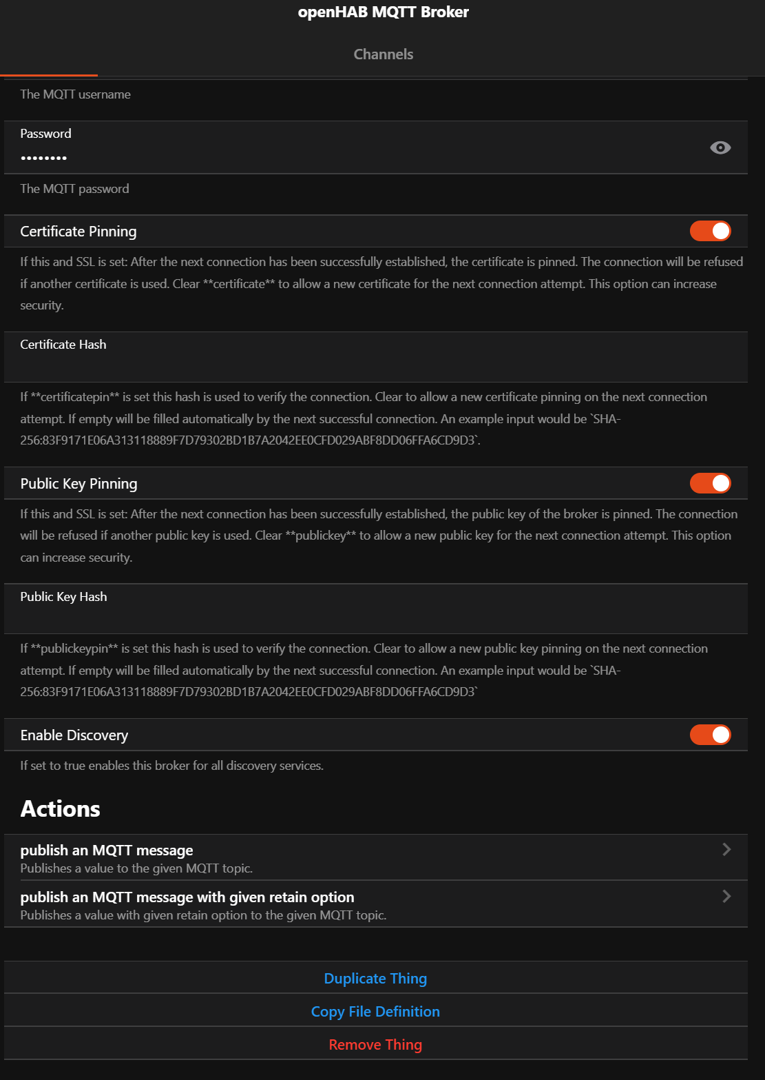

I chose the MQTT bridge that we see in the screenshot above when I created the Home Assistant thing, it’s the only MQTT broker I have on my LAN. A Home Assistant thing wasn’t autodiscovered when I created the MQTT broker, hence me trying to create a home assistant thing manually. I understand that the HA thing needs to know about the MQTT broker, it just doesn’t seem to work for me and I don’t understand what I’m doing incorrectly.
Discovery was already enabled on the MQTT broker thing:
I can’t see where the other options that @krishgcek mentioned are stored:

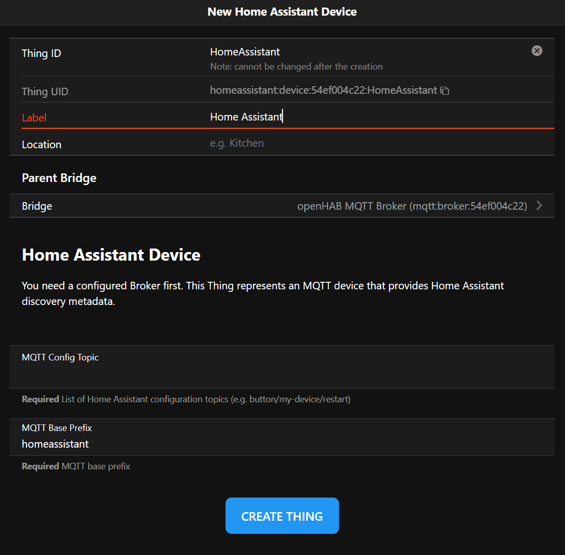

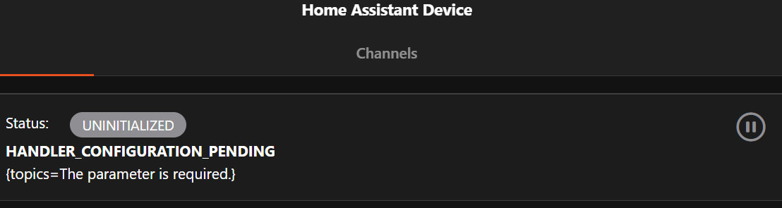

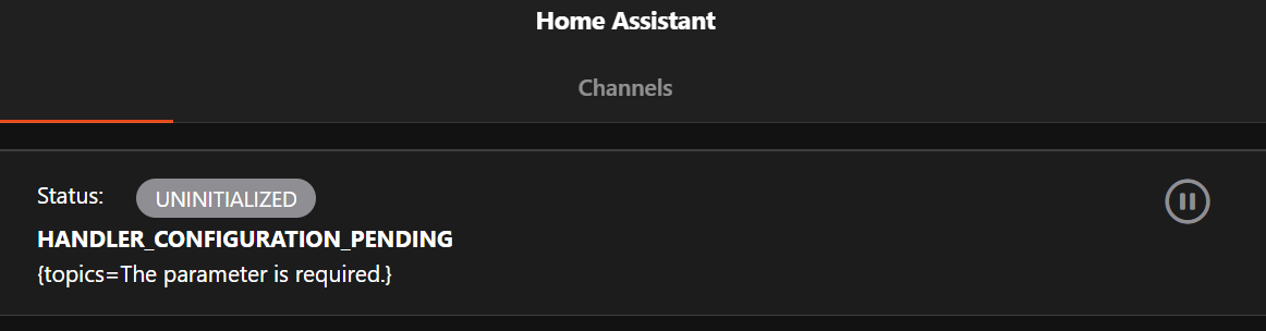

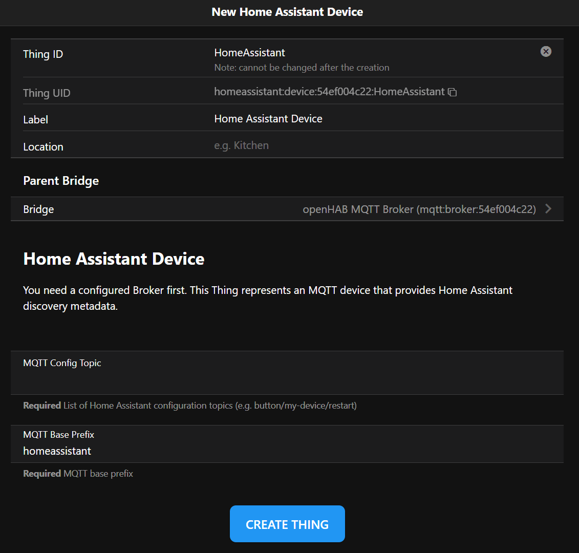

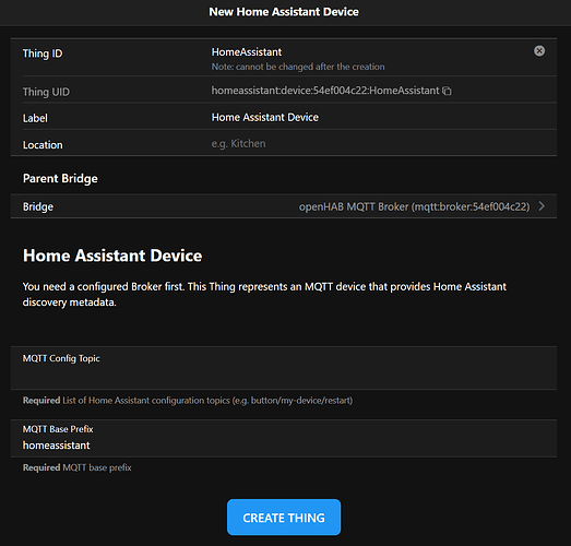

I deleted the existing Home Assistant thing and created a new one:
I click on the Home Assistant Device and give it a name and choose the bridge:

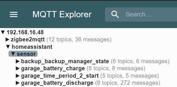

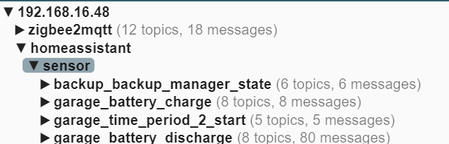

The base prefix is already homeassistant which is correct as show in the MQTT explorer screenshot I posted earler. I click on save and get this:
I’ve tried “sensor”, “/” and “+/+/” (without the quotes) with no success.

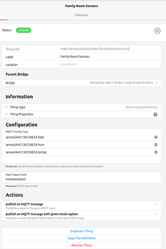

For example, here’s one of my HA devices:

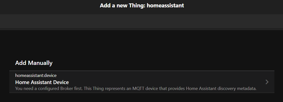

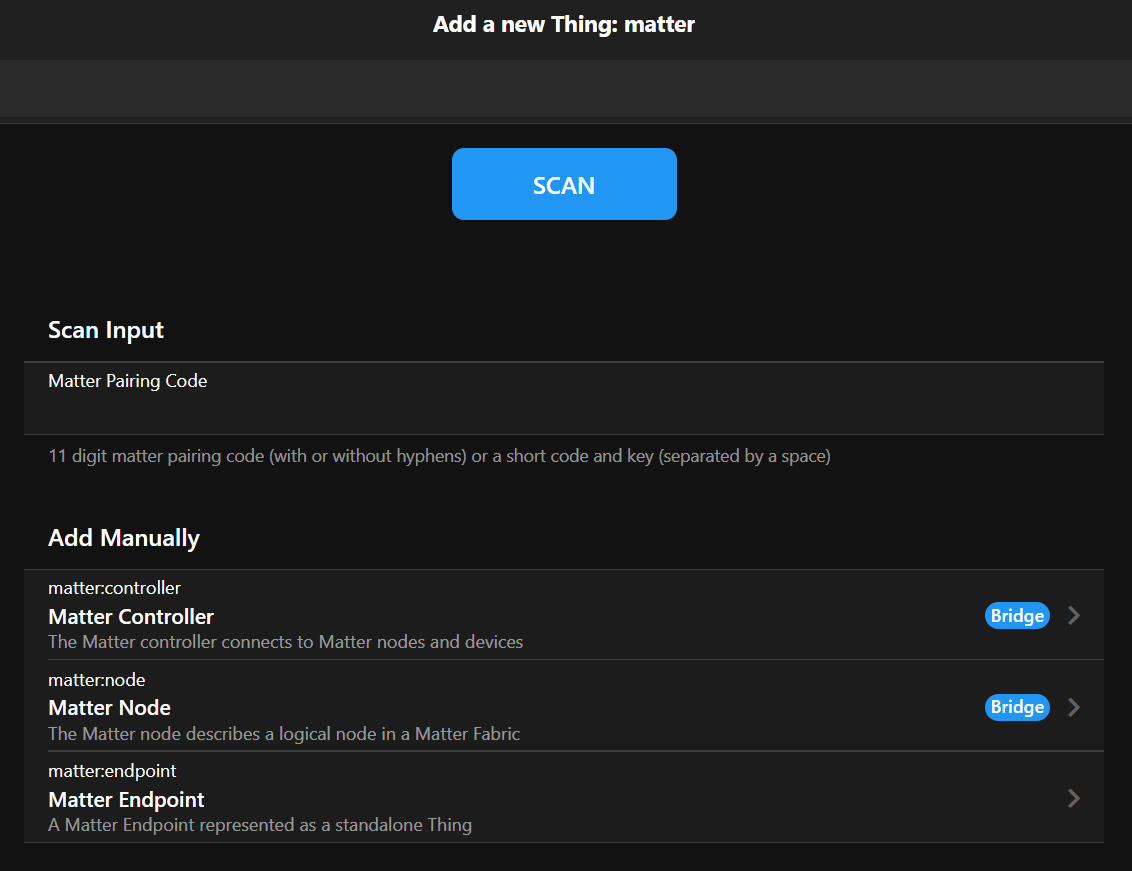

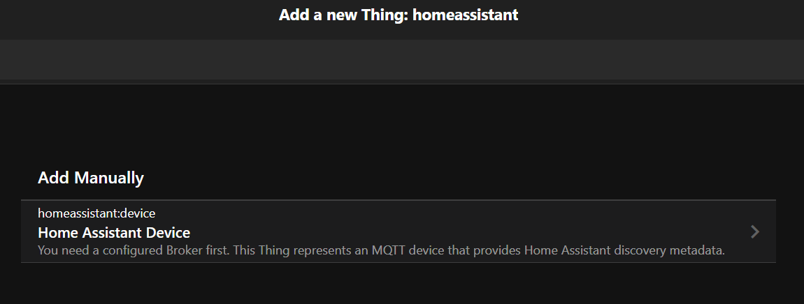

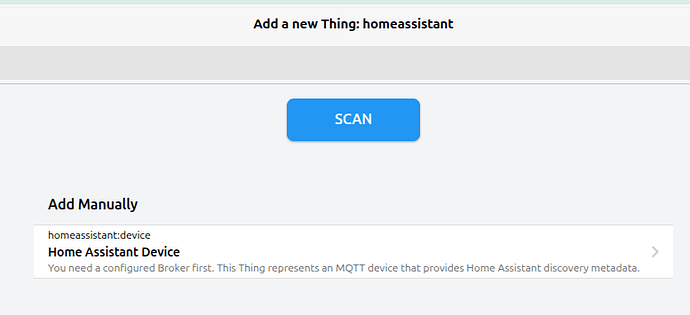

There is no scan button. The second screenshot in my previous message shows what I see when I create a new HomeAssistant thing. I only have the option to add it manually, there’s no blue Scan button. This is what I see when I go to Things → + → Matter Binding:
This is what I see when I go to Things → + → HomeAssistant Binding:
I have several other generic MQTT devices that I’ve configured already. I know the MQTT broker works. I’ve been attempting to create the HA thing so that I don’t have to keep on creating generic MQTT things and configure channels manually. I’m using generic MQTT things via the broker that is receiving messages from my HomeAssistant VM and my zigbee2mqtt service.
:person_shrugging:
This is what I see.
Something is preventing the binding from scanning. I don’t know what that could be. I’ve never not had a scan button there.
Even when I disable discovery on the MQTT Broker Thing I still have the SCAN button in the UI.

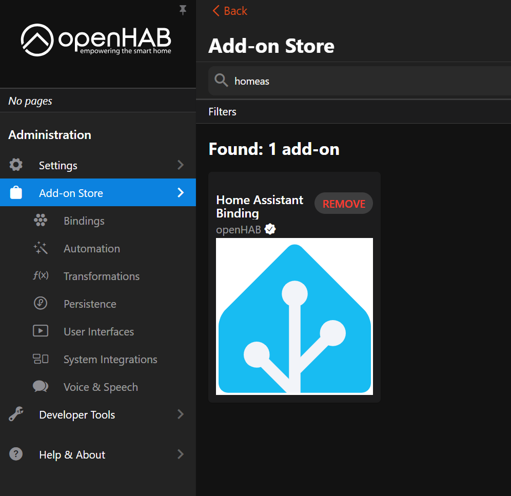

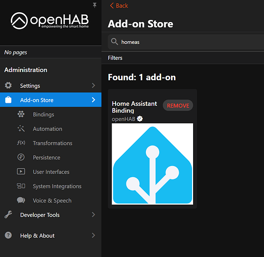

The HomeAsssitant binding itself doesn’t have any relevant settings under Settings → HomeAssistant.
Have you restarted OH as part of these experiments? Maybe the binding needs to be reinstalled (i.e. clear the cache). If you clear the cache, let OH boot for a while then, when OH settles, restart OH and watch the logs for errors.
If it’s still a problem, I think all I can recommend at this point is to file an issue on the add-on. There is something going wrong somehow.
I’d restarted OH a few times, yes. I hadn’t cleared the cache though, I just tried that. I stopped the OH service, ran openhab-cli clean-cache and then restarted the service. There’s still no Scan button. There are some shenanigans going on somewhere…
I’ll create a new Debian 13 VM, install OH and the MQTT and HomeAssistant bindings and see if the behaviour is the same.
I just created a fresh Debian 13.2 VM, added the OH apt repo, installed JRE21 and OH. Logged into OH and installed the MQTT add-on and created a broker thing. Next, I installed the HomeAssistant addon and waited for a few minutes to see if a HomeAssistant thing appeared in the inbox. It didn’t so I went through the steps to manually create a HomeAssistant thing as I described in a previous post. Still no Scan button:
I looked at the log and found this:

Does the HomeAssistant addon require Python to be installed?
That’s not going to do anything.
Yes, but GraalVM Python should have been installed when you installed the HomeAssistant add-on. The add-on uses the actual Python code from the HomeAssistant project to discover and process the MQTT topics and messages.
Do you see it listed in the bundle list in the karaf console? That could be the root of the problem.
How are you installing the HomeAssistant add-on, through the Add-on store?
Do you mean that you wouldn’t expect a fresh OH install with the HomeAssistant addon installed to have a Scan button like your install does?
The end of output of bundle:list looks like this:

No, what I mean is creating and configuring a Thing would make the SCAN button appear.
So GraalVM Python is installed and active. Something else must be going on.
