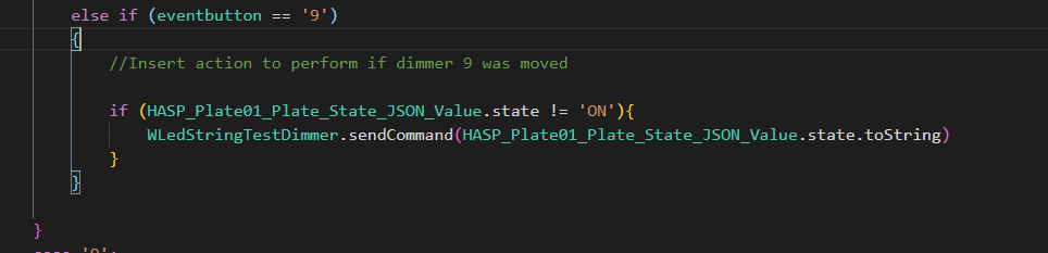

Lets use the Slider on page 8 located at b9
When it changes it triggers the code in this section
else if (eventbutton == '9')
//Insert action to perform if dimmer 9 was moved
We only want it to run if the value is not = to ON
So add
if (HASP_Plate01_Plate_State_JSON_Value.state != 'ON') {
WLedStringTestDimmer.sendCommand(HASP_Plate01_Plate_State_JSON_Value.state.toString)
Make sure you can control wled through sitemap first.
