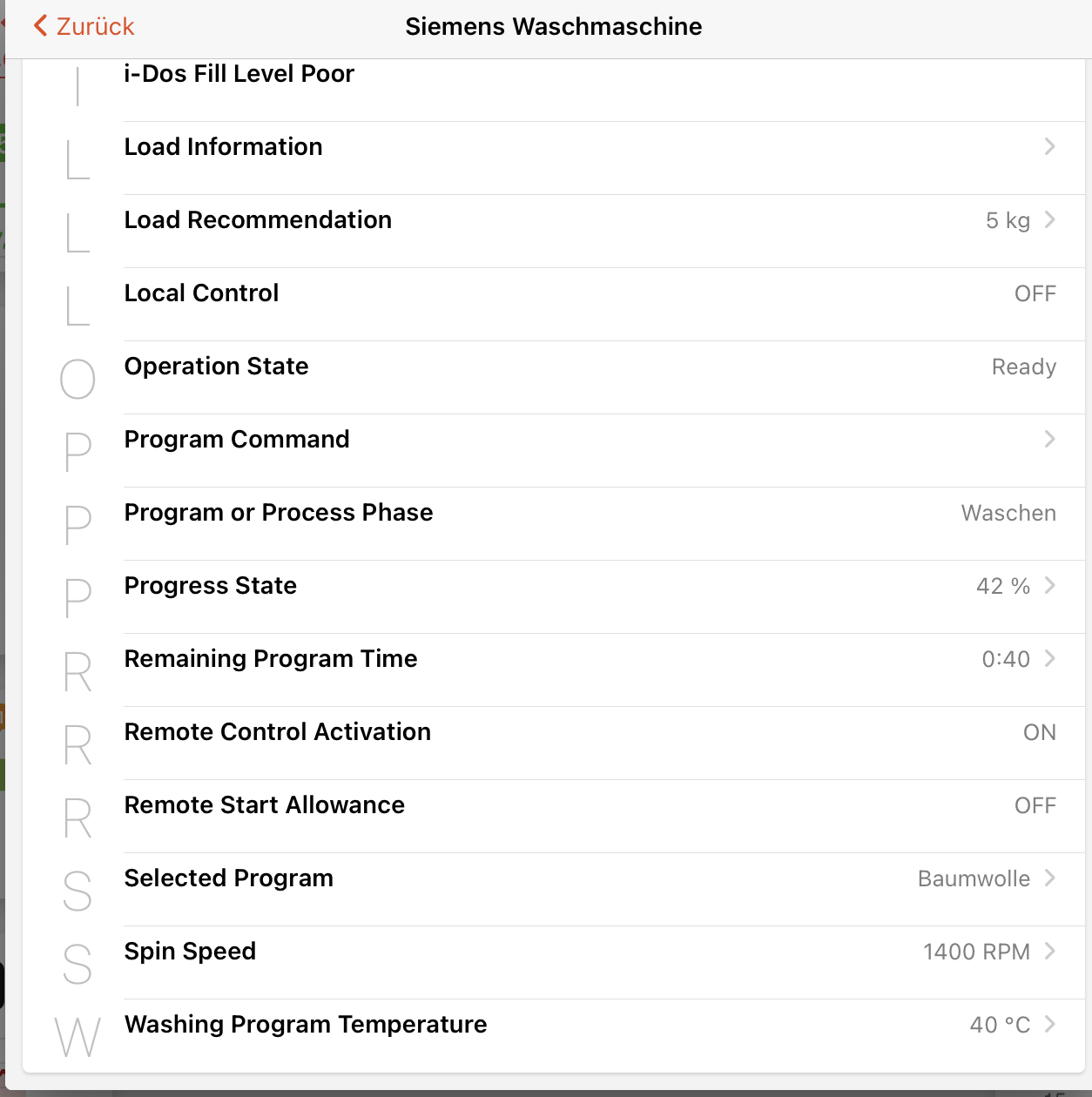

Thanks for testing! I have altered the code. The remaining program time now uses BSH.Common.Option.FinishInRelative and BSH.Common.Option.RemainingProgramTime as source input.
Can you please test again:

Hi Jonas,
thanks a lot for sharing the updated file. I will run some tests - so far it looks good :slight_smile:
Just came back from vacation :wink:

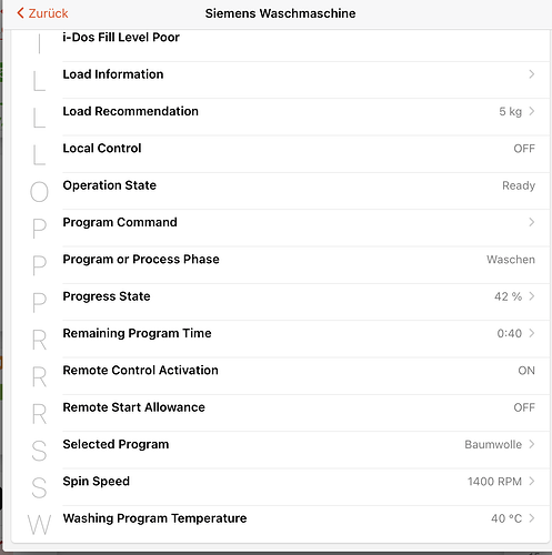

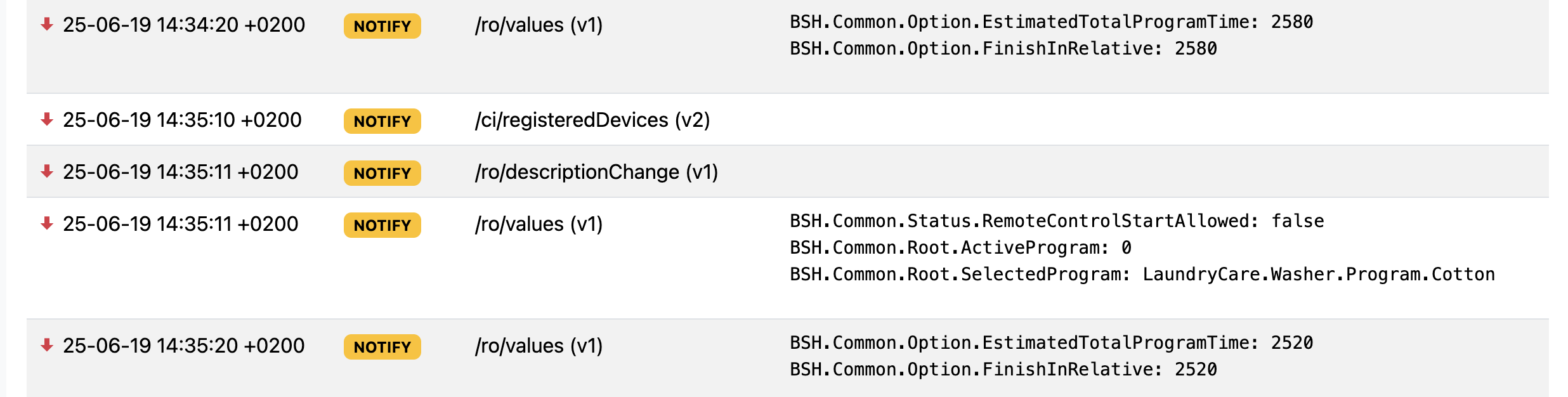

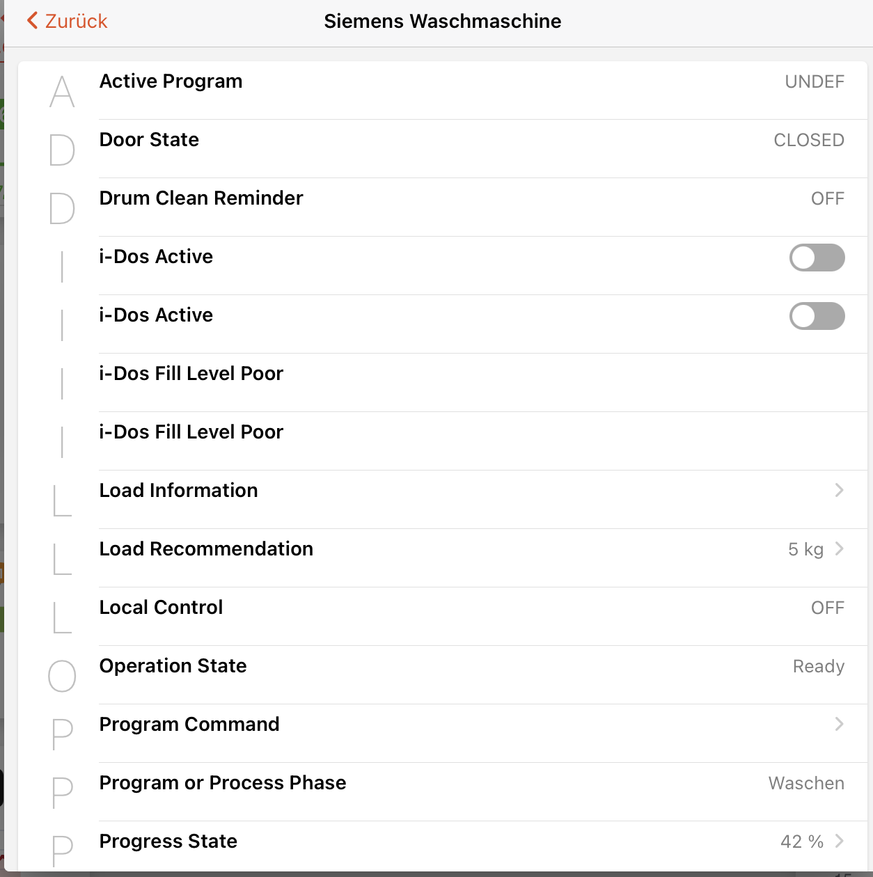

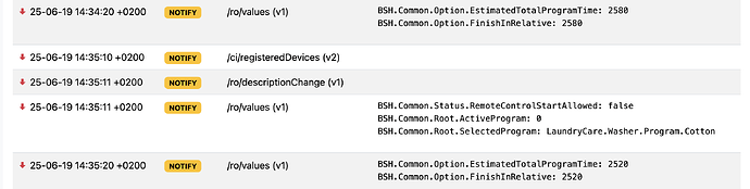

I want to report another issue I just reproduced.
If the washing is paused and resumed (to add some more items while a program is running already), the binding doesn’t show the correct ActiveProgram anymore once the door is closed again and the program is resumed - ActiveProgram is then UNDEF instead of Cotton (in the example below)
The log file is showing ActiveProgram: 0

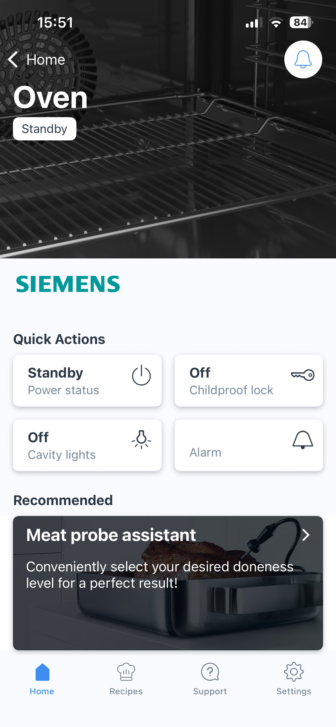

Sorry, I meant cavity light!
Use case: turn on light and see camera feed to check if there’s something inside before my wife pre heats the oven and burns my pizza…
At least for my oven i neither find an option in the HomeConnect app nor the binding to activate the light. Seems to be directly triggered by the door.
Interesting/ maybe a per device option.

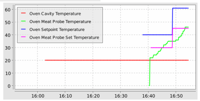

Cold autumn evenings lead to tackling unsolved openHAB problems again.
This binding works well, besides one unresolved issue:
I would like to access the Oven_CavityTemperature of my oven. Unfortunately it does only update once during boot time - or if the respective *.items file is changed/updated. Means: the temperature value is there, but just not updated. All other temperatures change as expected (see picture - the red line should change…). Getting the oven cavity temperature did also work with the cloud-based Home Connect Binding, though. Any help, ideas?
