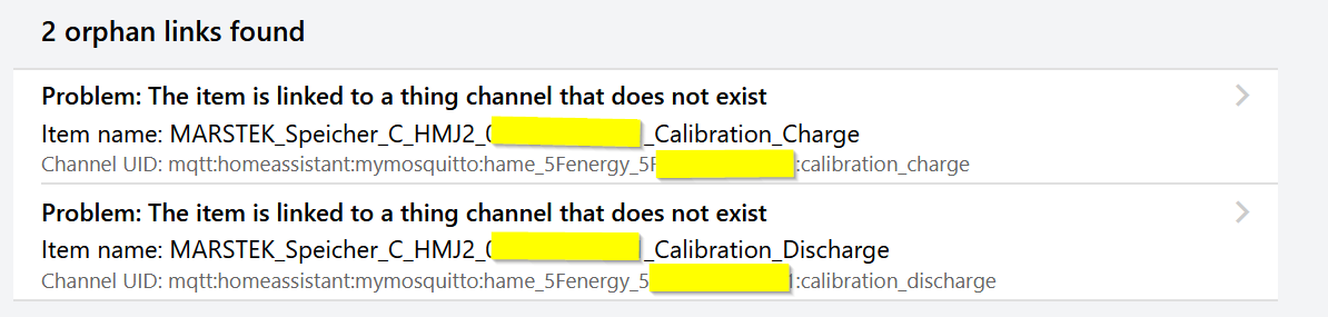

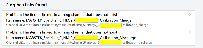

When i had to leave the house I had a lot (30+) health issues in OH.
Some minutes ago I checked the requested yaml thing and there were only 2 orphan link issues
The topic config in yaml is still present
grafik
But the channel definition is gone for these two channels.
And I know, when I had the issues with much more missing channels these were not in the yaml too.

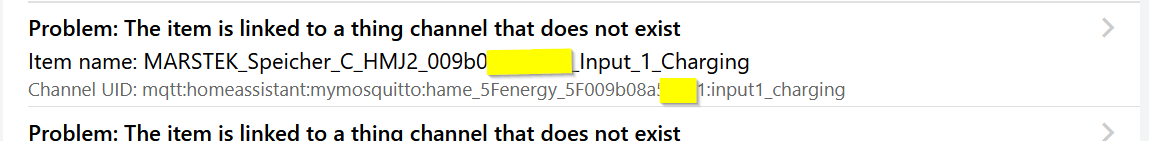

This is the error in Openhab:
In the channel this entry (as described above) is missing and the linked item is showing this error.
This is the missing code for the channel:

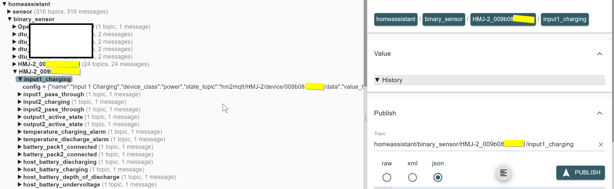

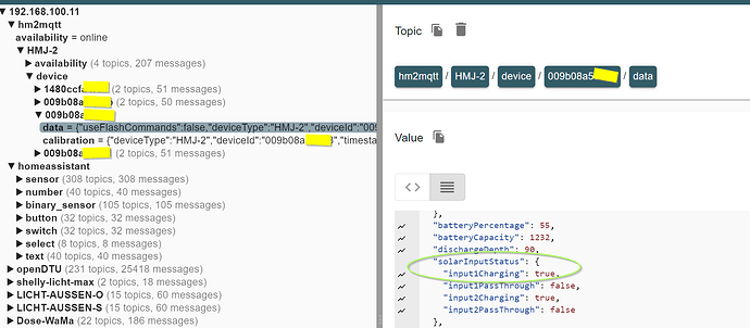

A look into MQTT Explorer shows this:
But I do not understand where on this way openhab is deleting existing channel code?

You need to find the corresponding discovery topics for the device under the “homeassistant” topic. That’s where the binding gets all the information to create the Thing.
The most likely cause of the problem is this discovery information is changing and leaving out “channels”. If the discovery JSON published there, the OH Thing will change so if a “channel” is removed there, the channel is removed from the Things.
There will be multiple topics for each device under homeassistant for each device.
There are two different syntaxes, DSL or YAML. You can choose use either in a file. But if the device is changing the discovery and topic stuff on the fly, you’ll likely just change the error or the Channels will just silently stop reporting anything.
You can also create a Generic MQTT Thing and define all the channels. Again, if the device changes what it publishes OH will just silently fail to update.
Also make sure that all the relevant homeassistant discovery messages are marked as RETAINED when viewing them in MQTT Explorer.

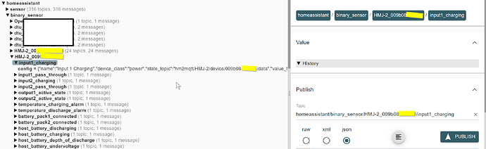

In MQTT Explorer I can see the homeassistant entries
But the retained sign is not there and the error message is also very present.
For my understanding.
The Things definition via homeassistant MQTT message is there.
If I copy the original complete code into the existing thing everything is fine.

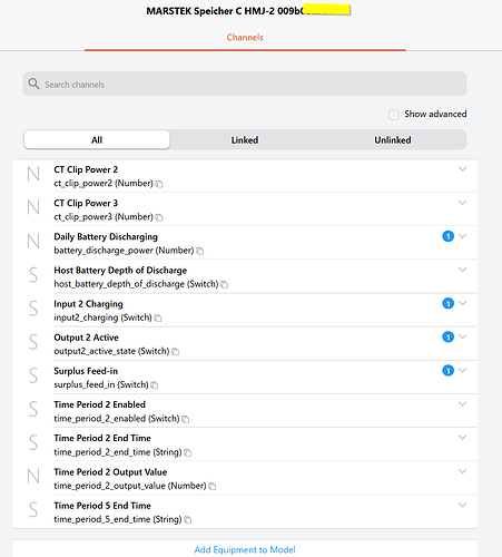

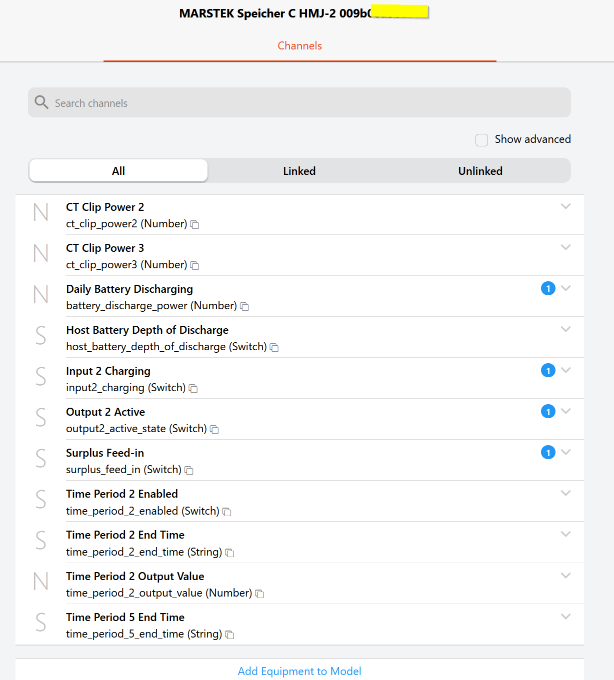

After a undefined time the thing channel definition ist partly gone. some are still existing
I am really desperate.
EDIT:
in OH GUI Things config I can see under MQTT Config Topic
all switches/sensors etc.
But some channels are not existing. Maybe this will help?

First, click on the actual message (the config line). That is where you should see the retained flag.
The retained flag is set by the publisher of the message. There is nothing you can do from the OH side to enable it.
But this confirms what I suspected. Whatever is publishing the config message is changing it. OH is going to change the Thing’s configuration based on what ever it finds there.
I suspect the retained flag is there, but you are reporting that the message is changing. This config message should not change. So the root of the problem is what ever is publishing this message and is nothing that can be addressed from the openHAB side. OH is doing exactly what it’s told to do.

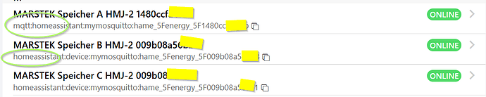

Another “funny thing”
I have 4 things acc. to the 4 Batteries.
All of them were created by autodiscovery from HA a long time ago (1 year)
B,C and D were in the meanwhile (looking for a solution of the error) deleted and rediscovered.
B,C,D (is like B/C) are more often the ones losing channels, but A is also involved, but more rarely.
