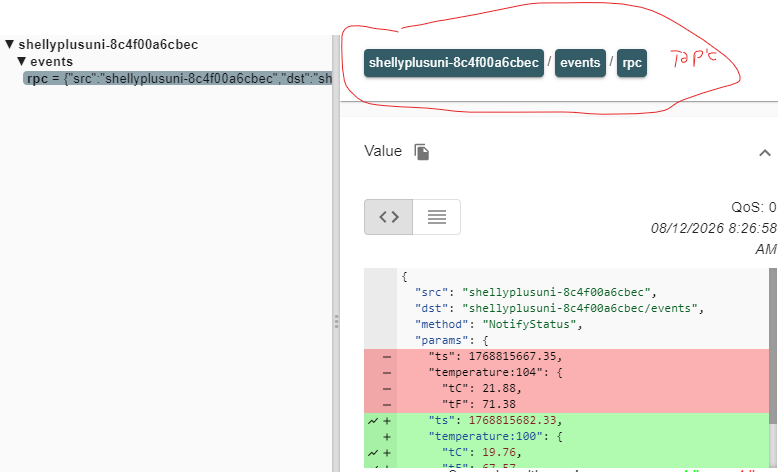

The topic is easy. It is the highlighted one in your post 7. The trickier part is the Transformation. I may have used AI in my similar situation with a shelly device. However, once you get one working you can just copy/paste in the code tab. Not an expert, but this is a working example with a JSON
The transformation to extract the temperature (100, 104 are separate thermocouples). On the code tab
      Furnace_Return_Air:
        type: number
        label: Furnace Return Air Temperature
          stateTopic: shellyplusuni-8c4f00a6cbec/events/rpc
          transformationPattern:
            - "JSONPATH:$.params['temperature:100'].tF" //This drills down to what you want. In my case it is the tF in the above picture
          formatBeforePublish: '%s'
          retained: false
          postCommand: false
          step: 1
          unit: °F
      Furnace_Main_Floor_Vent:
        type: number
        label: Furnace Main Floor Outlet Temperature
            - "JSONPATH:$.params['temperature:104'].tF"
          retained: false
          postCommand: false
          step: 1
          unit: °F

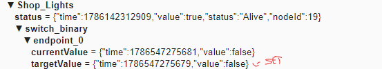

EDIT: My Shelly doesn’t have control channels, but here is another switch example (with true/false)
      Shop_Area_Lights_n:
        type: switch
        label: Shop Area Lights
          stateTopic: zwave2/Shop_Lights/switch_binary/endpoint_0/currentValue
          commandTopic: zwave2/Shop_Lights/switch_binary/endpoint_0/targetValue/set
            - JSONPATH:$.value
          "on": "true"
          "off": "false"
but I have explorer data for reference

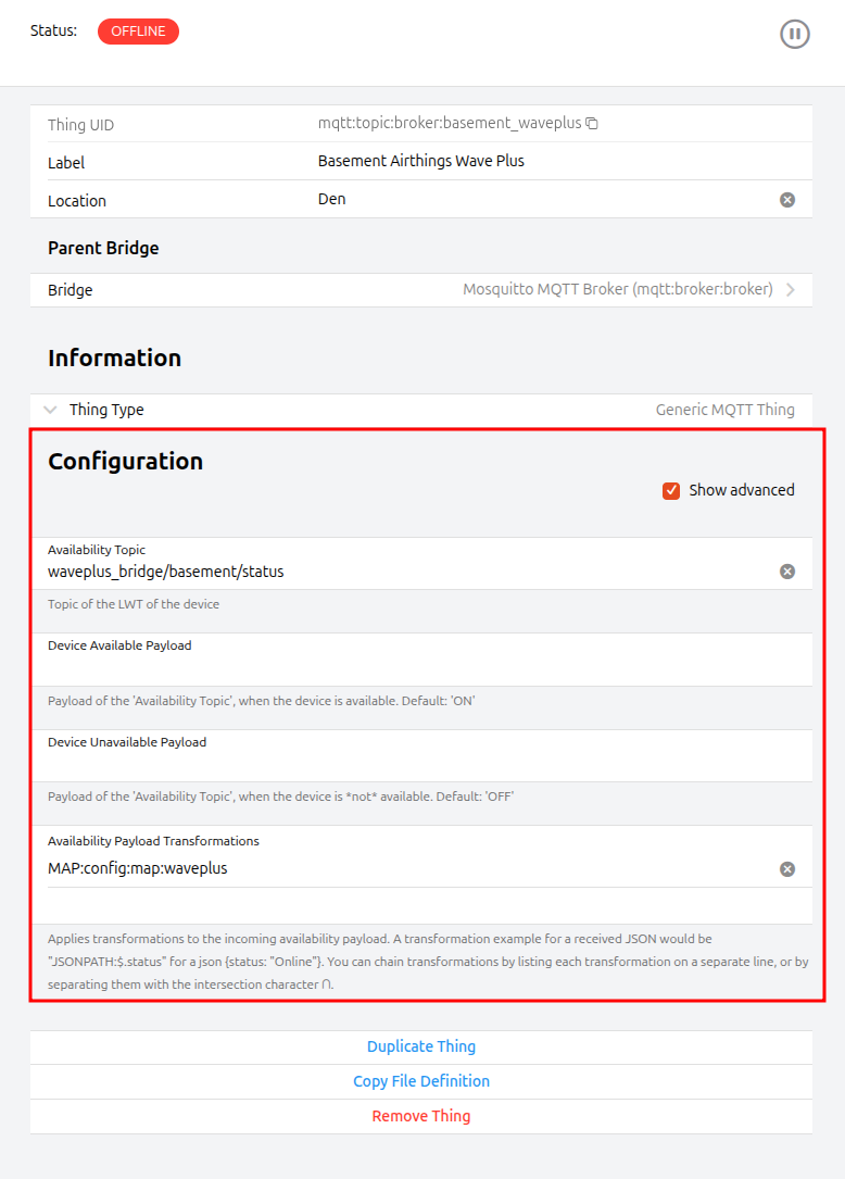

You have to configure the Generic MQTT thing’s availability settings.
Thanks, that’s it
