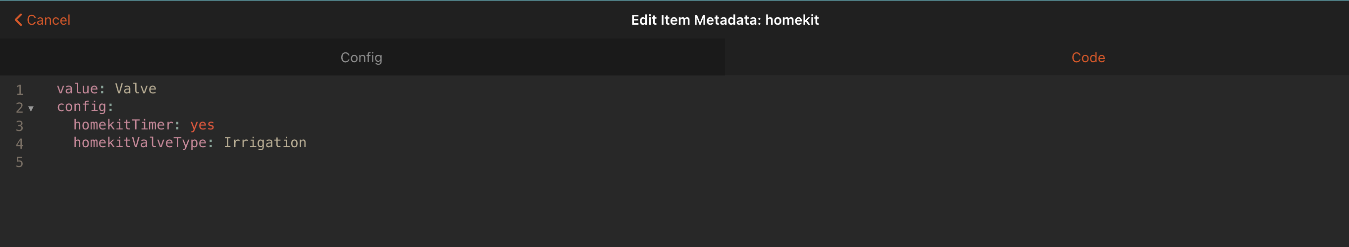

Hi Jacek,
you need to have a second item in the irrigation group for timer.
this is how it looks on my side

one point to check.
homekit add in supports both
  • external timer, i.e. irrigation solution can count down
  • internal timer - openhab counts down
by default, external timer is assumed.
in order to enable internal timer, add to the group
homekitTimer="true"]
it looks like this on my side
Thank you

could you please try to remove remaining duration item from the group and remove homekit tag on it?
no problem,
ok config changed but the behaviour is the same:
the valve “Kroplujce” is Valve2 in my setup:
