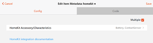

From the documentation I see this when Multiple Accessory/Characteristics are selected.

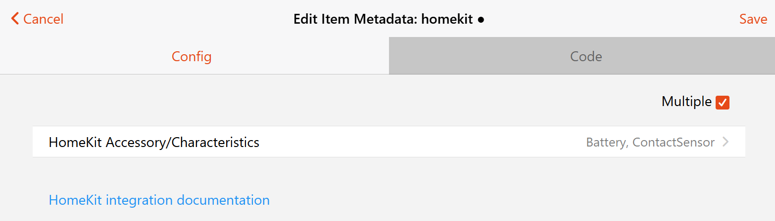

But when I do the same thing

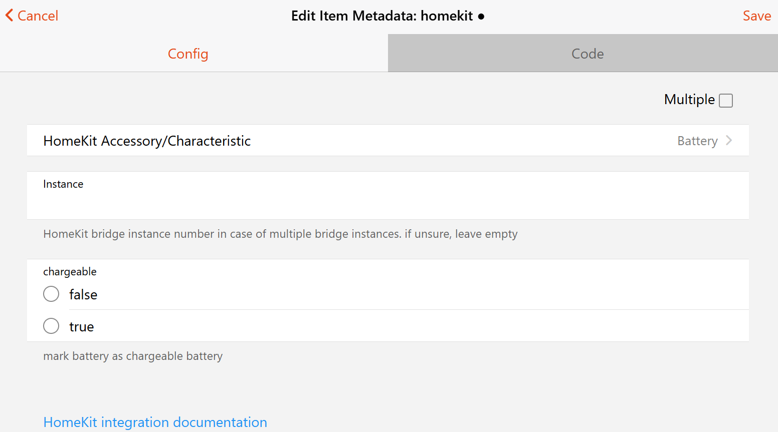

The config fields do not appear. If I select only Battery I can set the battery chargeable status but I do not see the “Group HomeKit Characteristics Mapping”
Am I doing something wrong or is it a bug?

i can confirm, same issue. so, probably bug.
i will further investigate this but it will get first fix probably with next release (OH 5.0)
till then you can use “Code” tab and do configuration there
