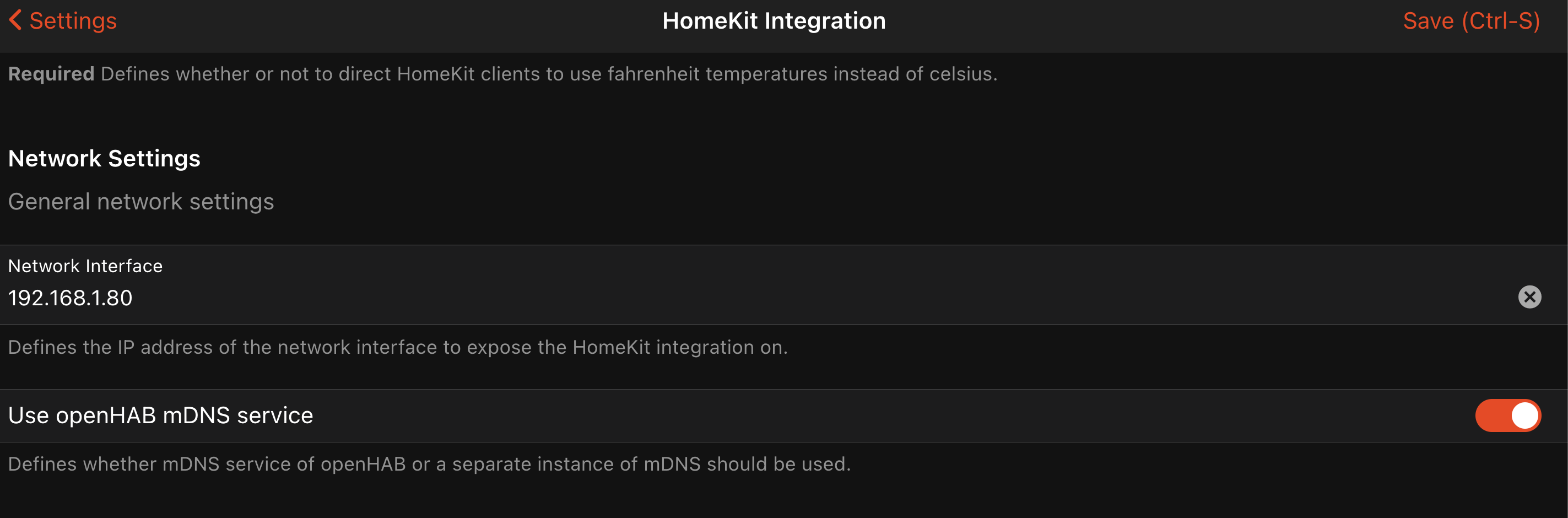

  • Use openHAB mDNS service is OFF

    Unfortunately, this had no effect. Only switching the mDNS flag helped for a few hours. Significantly more stability came from assigning a fixed IP for all my Apple devices. Now I only have to switch the mDNS flag every 2-3 days. Maybe my homepod mini (for example, because there is no option for deactivating private wifi address) causes the problem…?
As a workaround I would like to switch the mDNS flag from time to time via an automated script, is that possible?
this is an interesting idea. that would explain. need to investigate what triggers auto-restore and whether we can active some logging for it
if switching mDNS solves the issue then the root cause is on openHAB / homekit binding side.
the switch published the current IP address of the openHAB in mDNS repository on the openHAB node. ios home app sends to all nodes in your network request looking for mDNS repositories and at some point it will hit openHAB’s mDNS and find there the address and additional information about homekit binding.
i dont know why this information gets removed from mDNS after few days.
here you can find some discussions about this issue as well as an example of script that restart the binding if mDNS record get lost

one more thing to check -
do you have IP address set in homekit setting in openHAB mainUI, e.g.
