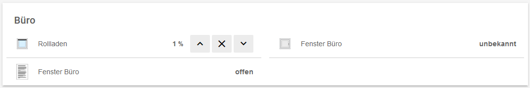

I own a few HMIP-SWDO-I window contacts and wanted to add them to my sitemap. However, creating items with type Contact doesn’t work. Adding an item with Type String works, though:
    Contact FensterkontaktBueroState "Fenster BĂŒro [MAP(window.map):%s]" (Fensterkontakt,Buero) { channel="homematic:HmIP-SWDO-I:3014F711A061A7DA498FAB79:00109A4996xxxx:1#STATE_CONTACT" }
    String FensterkontaktBueroStateStr "Fenster BĂŒro [MAP(window.map):%s]" (Fensterkontakt,Buero) { channel="homematic:HmIP-SWDO-I:3014F711A061A7DA498FAB79:00109A4996yyyy:1#STATE" }
    Frame label="BĂŒro" {
        Switch item=RollladenBuero
        Default item=FensterkontaktBueroState
        Default item=FensterkontaktBueroStateStr

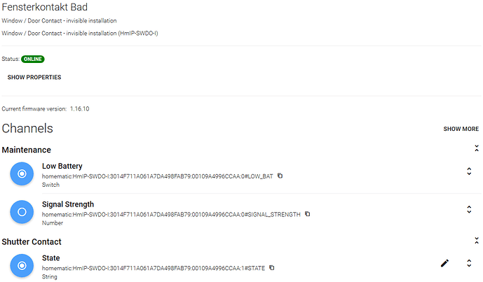

After some digging, I found out that for HMIP-SWDO* devices, a virtual channel called STATE_CONTACT should be added which can be used for Contact items (openhab-addons/bundles/org.openhab.binding.homematic/src/main/java/org/openhab/binding/homematic/internal/communicator/virtual/StateContactVirtualDatapointHandler.java at 2.5.x · openhab/openhab-addons · GitHub and [Homematic] HmIP Door Window Contact paired as String, not as Contact - corrected for HMIP-SWDO but not HMIP-SWDO-I · Issue #5786 · eclipse-archived/smarthome · GitHub). However, this channel is not shown in PaperUI. If I try to reference it in an Item, it doesn’t work either. The log file shows the error message

What I can see in the code a STATE_CONTACT channel should be created for all Homematic devices with names starting with HMIP-SWDO. Can you please enable TRACE mode, remove one of the window contacts and perform a new discovery. Then please post openhab.log (starting at the discovery).

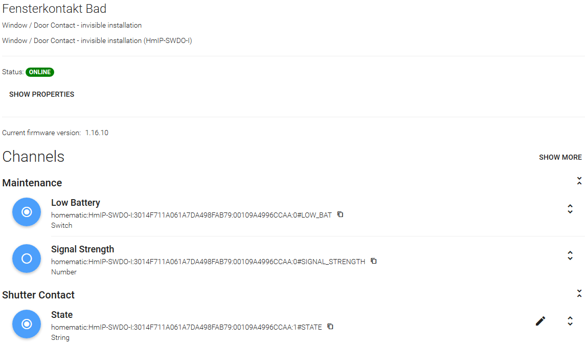

Also, I would like to have a screenshot from the thing definitions in Paper UI (would like to see the channel definitions).
If the information are not sufficient to find the reason for this problem I can prepare a jar file with some enhanced log information.

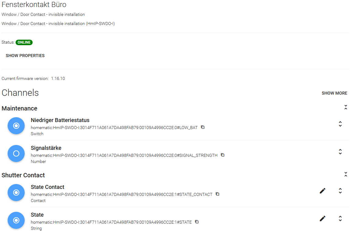

Interestingly, after removing a thing and re-discovering/adding it, the channel “State Contact” is shown.
This is a thing, which was not removed:
And this is the thing I just removed and added again:

Is it possible that you created the things before the issue was solved? If a binding changes a type or adds a new channel it is always necessary to remove a thing and create it again.

Yes, I created all things before the issue was solved, i.e. I did the initial discovery with OH 2.5.5 (most likely even an earlier version). I just deleted and re-added “Fensterkontakt BĂŒro” to verify that it is now showing the virtual channel.
