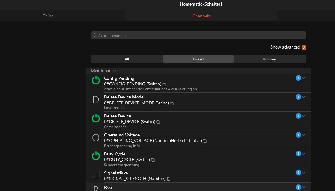

@flole,
not sure i get your question - does the attached screenshot answer it?
