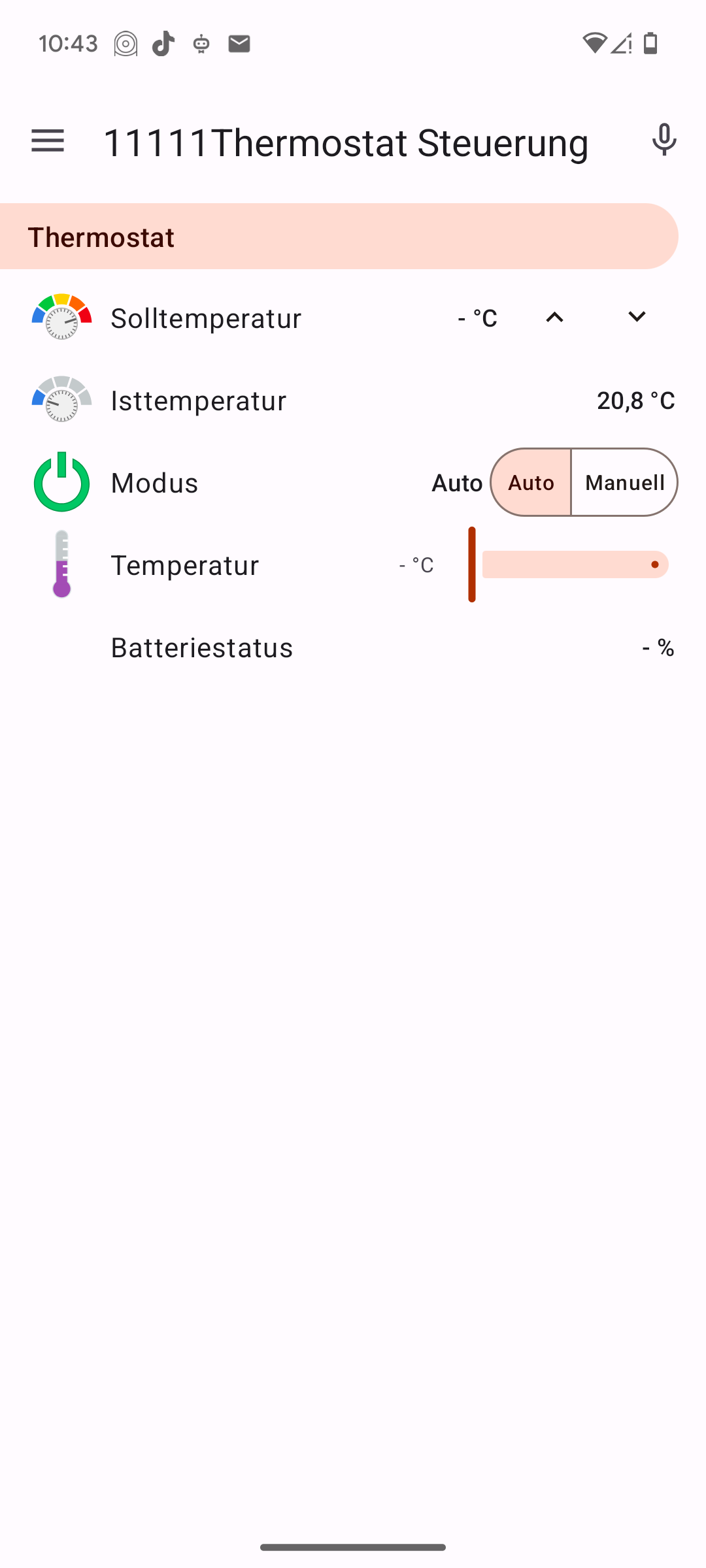

Thanks for the help i got the Problem with smoke detector solved. But the Problem with thermostat isn´t solved hear my config:
Item:
Number Thermostat_Setpoint “Solltemperatur [%.1f°C]” { channel=“homematic:HmIP-eTRV-B-2-Test:Test:1#SET_TEMPERATURE” }
Number Thermostat_Temp “Isttemperatur [%.1f°C]” { channel=“homematic:HmIP-eTRV-B-2-R4M:Test:1#ACTUAL_TEMPERATURE” }
String Thermostat_Mode “Modus [%s]” { channel=“homematic:HmIP-eTRV-B-2-R4M:Test:1#CONTROL_MODE” }
Number Thermostat_Battery “Batteriestatus [%.1f %%]” { channel=“homematic:HmIP-eTRV-B-2-R4M:Test:1#BATTERY” }
Sitemap:
sitemap default label=“Thermostat Steuerung”
Frame label=“Thermostat”
Setpoint item=Thermostat_Setpoint minValue=5 maxValue=30 step=0.5 icon=“heating”
Text item=Thermostat_Temp icon=“heating”
Switch item=Thermostat_Mode mappings=[0=“Auto”, 1=“Manuell”]
Slider item=Thermostat_Setpoint label=“Temperatur [%.1f °C]” icon=“temperature”
Text item=Thermostat_Battery label=“Batteriestatus” icon=“battery”
What is the problem?
Btw, marking the code as code improves readability.
i cant control the thermostat manualy:
the logs contain the following problem :
Converting type DecimalType with value ‘25.0’ using QuantityTypeConverter to datapoint ‘123456789:1#SET_POINT_TEMPERATURE’ (dpType=‘FLOAT’, dpUnit=‘°C’)
2025-01-22 08:49:16.016 [WARN ] [ternal.handler.HomematicThingHandler] - Can’t convert type DecimalType with value ‘25.0’ to FLOAT value with QuantityTypeConverter for ‘123456789:1#SET_POINT_TEMPERATURE’, please check the item type and the commands in your scripts
when i change the temperature in homematic, this change is also displayed in openhab
