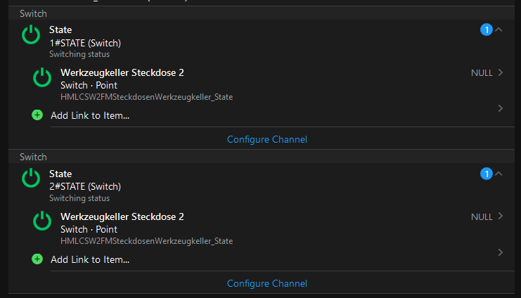

This works perfectly fine with OH2.5.9, but when I try to link the two different channels in OH3, the new item always replaces the old one and is linked to both channels.
Linked channels in OH2:
Linked channels in OH3, after I had linked channel 2 to an item “Werkzeugkeller Steckdose 2” and added the second link to channel 1:

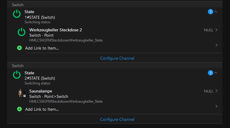

After adding another link, it seems to be fine at first. (items are swapped in this example)
Screenshot taken, right after the create link popup closed:
But after closing and reopening the Thing, the configuration is changed and the new item replaced both links:
When I hit the save button (or visit the code tab and go back to the channels tab, I get a warning that the configuration has validation errors:
When the new item is added, the old item gets removed, not only unlinked.
I restarted the docker container and tried the same procedure with the same result.
Even after deleting and recreating the thing, the issue is the same.
After adding the thing again, I immediately switched to the code tab and back to the channel tab and got the same validation error.
