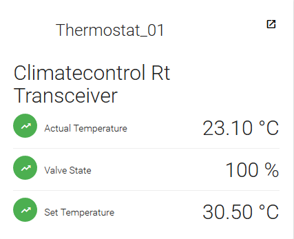

Unfortunately, these values will not be passed to the items:
The values of the items change only when I am making changes at the items themselves.
