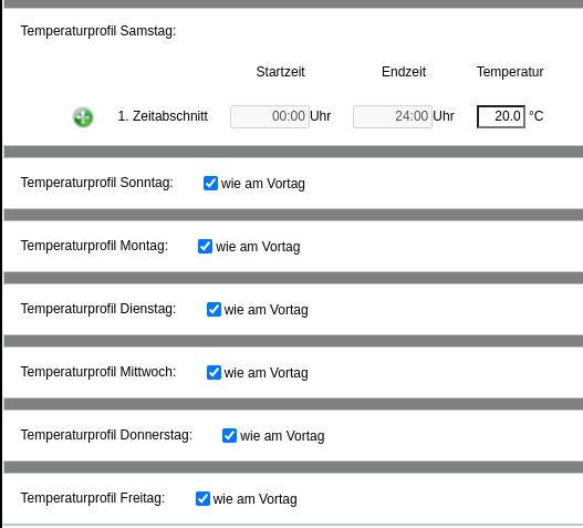

The Week Profiles:
Hi !
I tried with one of them but still the same effect
