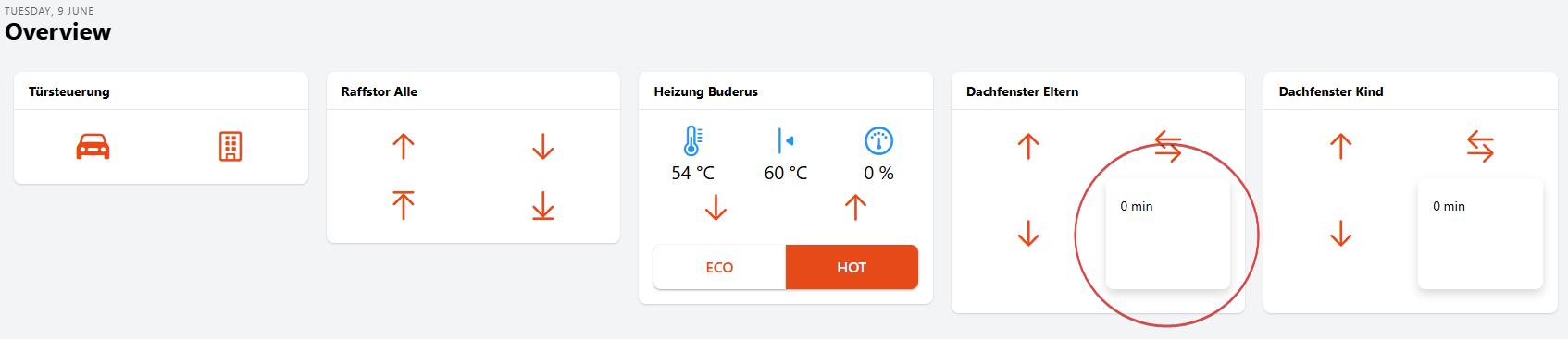

Hi there,
I made a couple of widgets for my Overview page. I am struggling with my Dachfenster (skylights) widget. I have a vertical slider to adjust the number of minutes it stays open and it looks very bulky. I want to have a minimal size just like my arrow icons/buttons. I tried various height and max-height settings, but i cant seem to influence the resulting html (350px height):
Here is the widget code:

thanks for your reply. I guess what I really want is just the value in a minimally/compact cell, and clicking the cell making the slider pop up. What is the easiest way to get that?
Easy is, of course, not the same for everyone. But, probably the shortest configuration that will accomplish this without extra problems is:
- component: oh-link
    text: Value
    popoverOpen: '#sliderPop'
- component: f7-popover
    style:
      padding: 10px
      height: min-content
    default:
      - component: oh-slider
          item: testNumber
At issue is the fact that the cell components in particular already have a lot of css styles applied to them. They are not really meant to be altered but are instead intended to be a low code as possible for a basic grid of cells layout. Cards are slightly more general (that is, they have less css already applied to them and are designed to allow you to easily apply css to their various regions). But they also still come with the “card” visual outline. If you really want an second outline within your main card outline then you can use a card, but that will still take more effort to get the specific effect you want.

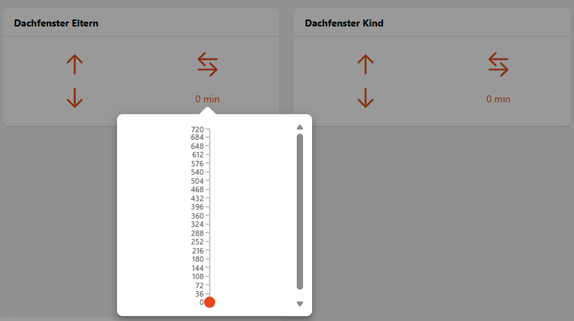

thank you so much for your help. I have tried incorporating the changes but now the slider seems cut off and won’t accept my config (scale, description, vertical, etc…)
after click:
code:
          - component: f7-row
              class:
                - align-items-center
                - display-flex
                - justify-content-space-between
                - align-content-stretch
              default:
                    text: =items[props.itemDFAutoTimer].state + " min"
                    popoverOpen: "#sliderPop"
                    style:
                      padding: 10px
                    default:
                          item: =(props.itemDFAutoTimer)
                          min: 0
                          max: 100
                          step: 1
                          vertical: true
                          verticalReversed: false
                          scale: true
                          scaleSteps: 5
                          scaleSubSteps: 4
                          label: true
                          releaseOnly: false
The slider is configured exactly as you have set it. But you’ve run into a common css issue: your slider is 0 pixels tall.
When you set the slider to vertical, its height value is set to 100%. Because of the way that the F7 library does it’s modals like the popover, they don’t have a height value that the slider can be 100% of. 100% of “I don’t know how tall I am” gets you 0 pixels. So, if you want the vertical slider you will have to add some extra style to the oh-slider that sets its size a little more manually.
style:
  height: 300px
  width: 100%
  margin-top: 10px
  margin-bottom: 10px
should be sufficient, or at least close.
