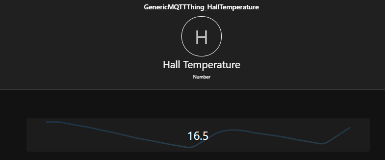

Thanks. So on the inbound (set up in the UI) I have:
and sure enough it is displayed at 1DP:
However the underlying number is unaffected e.g.

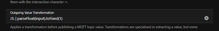

To handle the second case, on your MQTT Thing, there is a transformationPatterOut property on the Channel. You can put any transformation there that you want. For example, this JS transformation will round the value to one decimal place
JS: | parseFloat(input).toFixed(1)
You can use Rules DSL too or any of the other languages. But it’s pretty awkward in DSL. Everything is awkward in DSL, which is one reason I no longer recommend it for new development anymore. Any advantages it once had have been met or exceeded in all the rest of the rules options now.

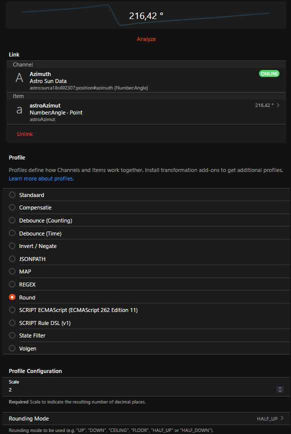

Here is an example where I round the Azimut value of the Astro binding:
It is correctly displayed in in the log:
Item 'astroAzimut' changed from 215.34230346192476 ° to 215.34 °

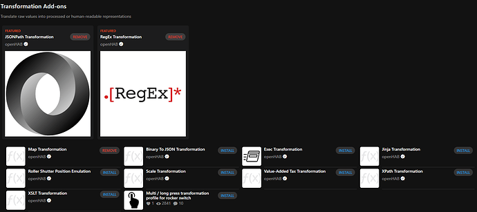

Yes, like I said above, it’s an add-on. Add-ons always have to be installed before you can use them. I would expect to see errors in the logs if it’s not installed.
I can’t see this add-on in the Add-On Store. I only have “JavaScript Scripting” installed. It is definitely defined in the item, does not seem to do anything and, at the same time, is not generating any errors in the log.
Number roundedNumber {channel=“mqtt:topic:296339e167:bd0065781b:HallTempRounded” [profile=“basic-profiles:round”, scale=1]}
