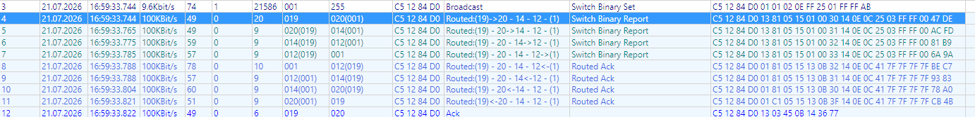

I did a recent scan captured on my zniffer. The device is maybe 20 ft from the controller, so is fast (100Kb) but a bunch of hops. Since you have experienced drops it is hard to say without zniffer data.
Note on this thread topic; This device is not compliant since it responded to a Set with a Report (no poll). (I created this to copy the device manufacturer in a DM).
