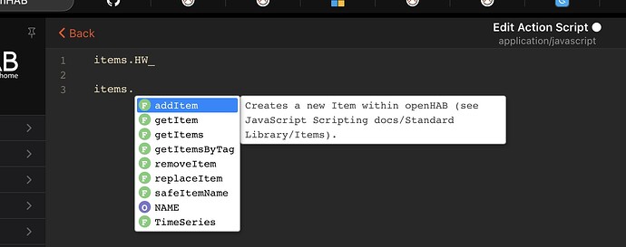

By installing openhab from npm and importing manually const { items, rules, ... } = require('openhab'), your IDE will see the type definitions of openhab-js and provide autocompletion.
The script editor in the UI is also able to provide autocompletion.

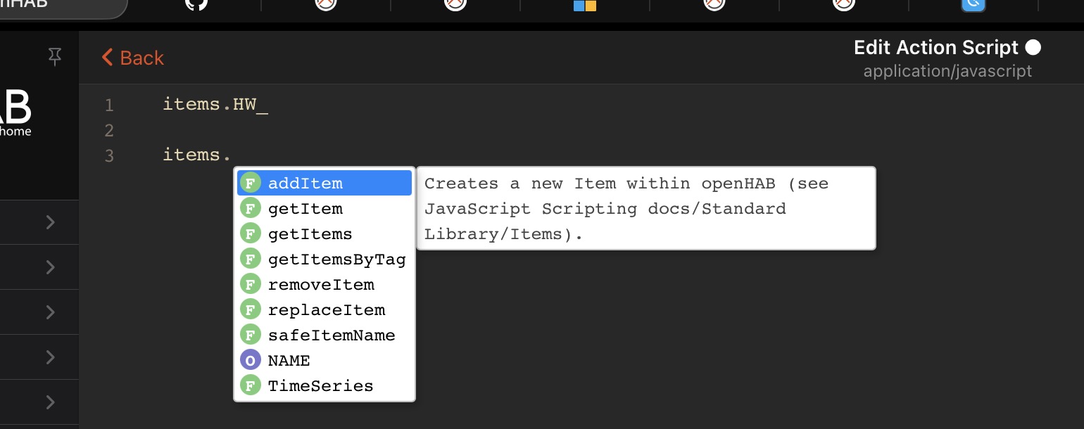

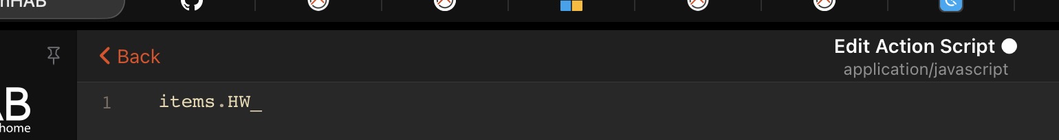

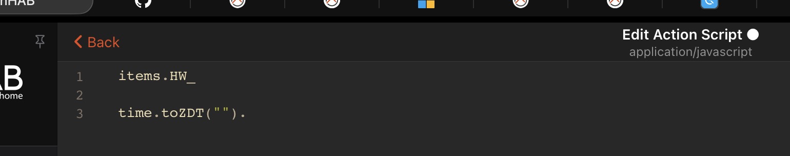

With the UI, I haven’t been able to get data from the items, things, etc.:
Only some simple stuff:
I’ve tested with a new rule and with the Scratchpad, but got the same results.

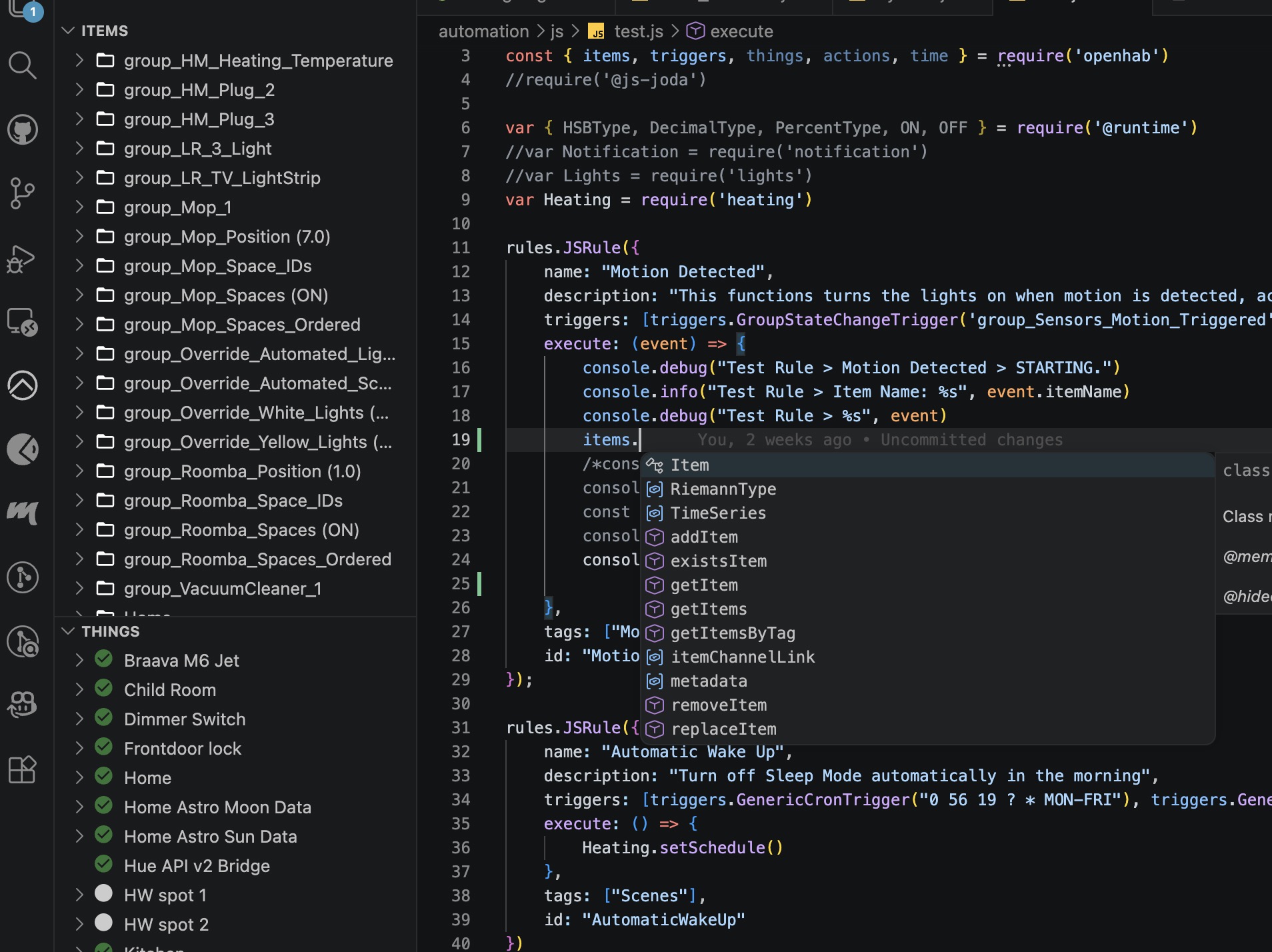

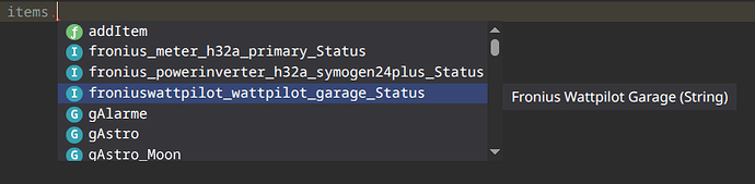

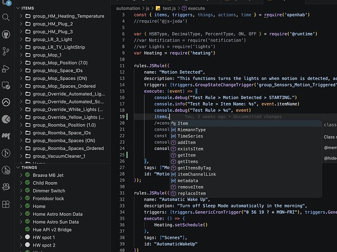

Update: Autocomplete with the openhab-js library is now working on VS Code. If I could connect to the REST API and Language Server, would the autocomplete also consider the items and things in the OH server?

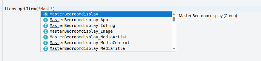

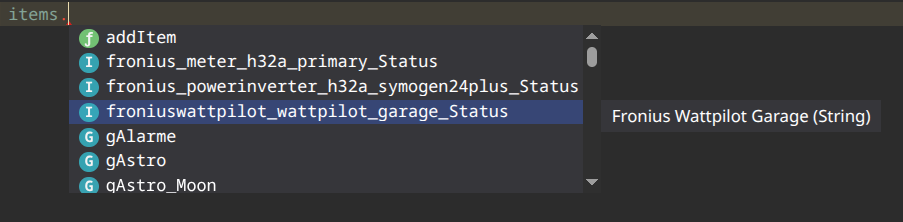

Items autocompletion works for me after typing items., but it isn’t implemented for items.getItem(...:
I am on openHAB 5.2.0.M1 though, but checking the demo.openhab.org instance on 5.1.3, this works there as well.
Thing name autocompletion isn’t implemented anywhere I think.
The language server is only needed for openHAB’s DSL. The REST API is where the information about Items & Things comes from, but the openHAB VS Code extension doesn’t provide Item name completion for JS. The extension has no active maintainer AFAIK, last commit three years ago: GitHub - openhab/openhab-vscode: VS Code extension for openHAB configuration files · GitHub. I can see a PR v1.0.1: JS hover tooltips and log-based state extraction by s0170071 · Pull Request #329 · openhab/openhab-vscode · GitHub that seems to add Item name autocompletion.
It’s working both ways for me. But I’m on 5.1.1 at the moment. Maybe there’s a regression?

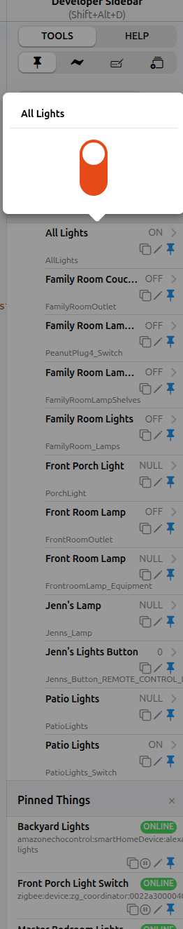

@nelson.aponte, also, don’t forget about the developer sidebar where you can pin the relevant Things, Items, etc. and not only see them but interact with them, copy the UIDs, etc.
I have tested it on 5.1.3, 5.2.0.M1 and a milestone build from today, and it works on all three. So if it doesn’t work for @nelson.aponte , there must be a specific issue in his setup. Anything in the browser console?

I upgraded yesterday to 5.1.3, and I can confirm that the Scratchpad does autocomplete, just as you mentioned @rlkoshak.
Only VS Code doesn’t autocomplete item names, even though the REST API returns all items. Is it a bug or is it expected?
It’s not implemented, so yes it’s expected. The good news is, that it is worked on, the VS Code extension slowly gets developed again after several years of no changes.
