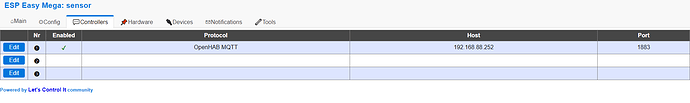

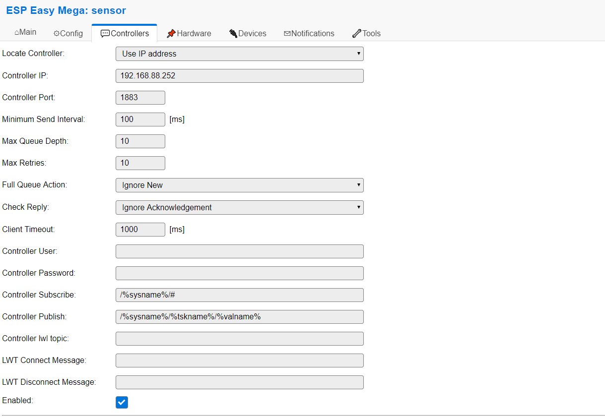

Thank you @sihui,
I’ve installed MQTT on the openhab, flashed nodeMCU and made it working with the DHT22(picure below)
and also set up the protocol
Maybe do you know how can I now link the sensor with the openhab in sitemap and item’s folder?

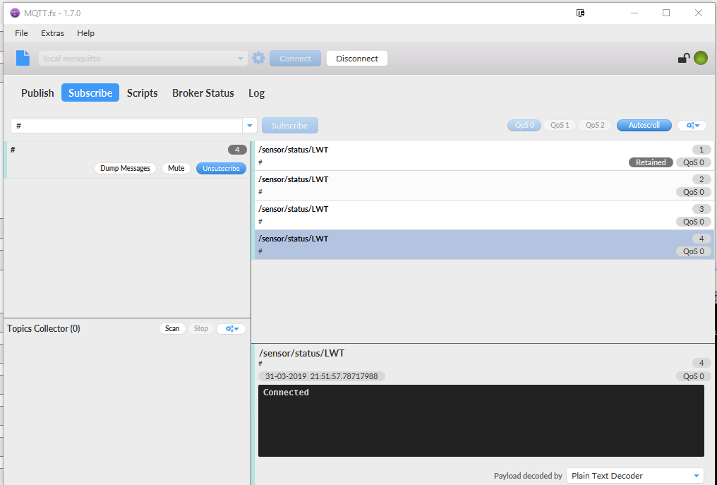

P.S. I’ve also checked the MQTT.fx and it seems to be working

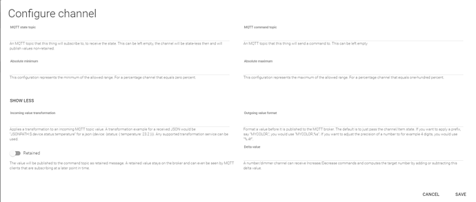

Create a Generic MQTT Thing manually, add a number channel, fill in the topic you have chosen in your ESPEasy as a state topic, for example:
Create a number item and link the channel to it
then display the number item on your sitemap

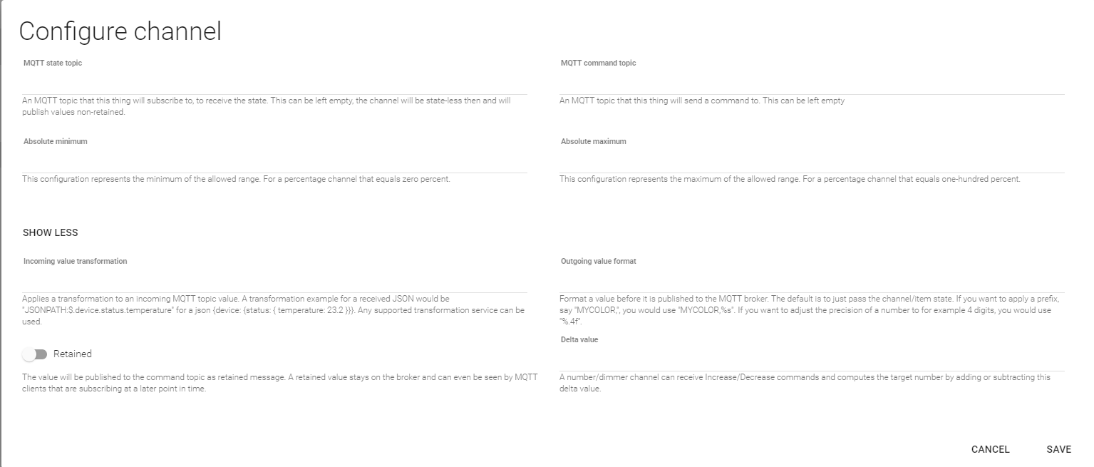

and I hit the wall at the channel configuration because I don’t know how is MQTT state topic is named as.
Where can I find this information? MQTT.fx or in the espeasy software?

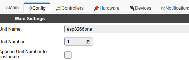

The first part on the ESPEasy config page (unit name), the second part on the ESPEasy device page:
In this case the state topic for the temperature would be:
/esp8266one/dht22/temperature

Now I configured this channel and it shows offline status(sensor is online) is this a bad thing?
You haven’t yet configured the broker thing.
