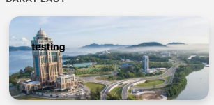

On bigger, it is like below:
But, on smaller screen, it is like below:
My question is, how do make the image fully cover the cell without leaving space below when the cell width is shortened? TQ
The problem here is the compound nature of the oh-cell. By the time you have added an oh-image to the background slot of the cell there are numerous html elements stacked in such a way that it is pretty difficult to get css that will size the image correctly. Presonally, I would actually not use an oh-image for this, but just use a div and put the image in the background using css. Then the only extra element you have to deal with is the additional div that is added when a cell has a background. That’s a little trickier and requires adding a stylesheet to the cell with more complicated than usual css selector:
- component: oh-cell
    stylesheet: |
      div:has(.back-image){
        height: 100%;
    background:
      - component: div
          style:
            background-image: url('/static/images/KK.jpg')
            background-size: cover
            height: 100%
            width: 100%
          class:
            - back-image
            - card-opened-fade-out
The background-size: cover on the div is all you need to keep the image always filling the space no matter what aspect ratio the cell has.
I’ve added the custom class back-image to that div so that I can specifically target the extra background div with the css selector div:has(.back-image) (which just says “select any div element that contains another element with the class ‘back-image’”). This extra stylesheet css is the only way that your div element with the background image is going to have a vertical size greater than 0 becuase otherwise it is just an empty element.
Great it works
