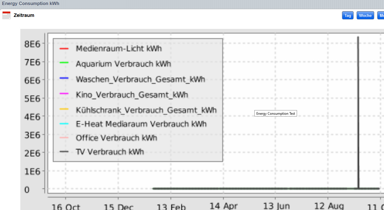

I persist a lot of values to create charts, e.g. energy consumption.

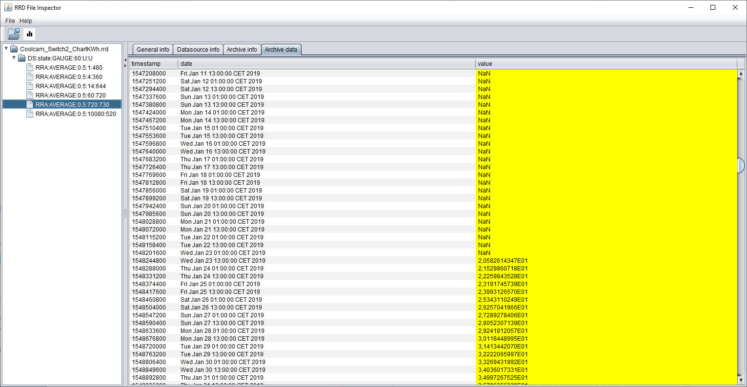

Unfortunately in influxdb or rrd4j i get NAN (not a number) values in the database in the chart they are shown as very big or verx negative numbers (e.g. 4e8), which totally ruins the chart as the scale is so big now.

The NAN values are not the problem, RRD4J filters them, but I have very few invalid values, e.g. 8e6 in my persisted series.
Actually these strange values come from ZWave power plugs. They track the energy consumption, but sometimes the values are non-sense.
But as they are persisted, they destroy the charts.
