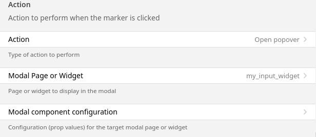

All of the floorplan markers rely on OH widget actions to perform whatever interaction you want to configure. To go beyond the basics then, you need to understand actions and their various options. Basic introductions to actions are available in the getting starting tutorials:
and a comprehensive list of action (with example configurations) is available in the oh-button reference page:
In this particular case, the action you are interested in is one of the modal actions (popup, popover, sheer actions). Looking into the the details of those, you will see that they each allow you to open up in some way of your choosing any other page or widget you have already created. So, all you need to do is create a custom widget that includes the input component. Then you configure the floorplan marker to open up that custom widget.
You say you’ve already worked out the input card, but just for completeness, here’s a basic example of the minimum config you would need:
uid: my_input_widget
tags: []
props:
  parameters: []
  parameterGroups: []
component: oh-input-card
  title: Input a value
  type: text
  sendButton: true
  outline: true
  item: YouItemNameHere
Once you have saved that custom widget, then you can configure the action in the marker wizard:
After that, clicking on your floorplan marker will result in:
