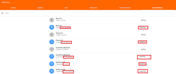

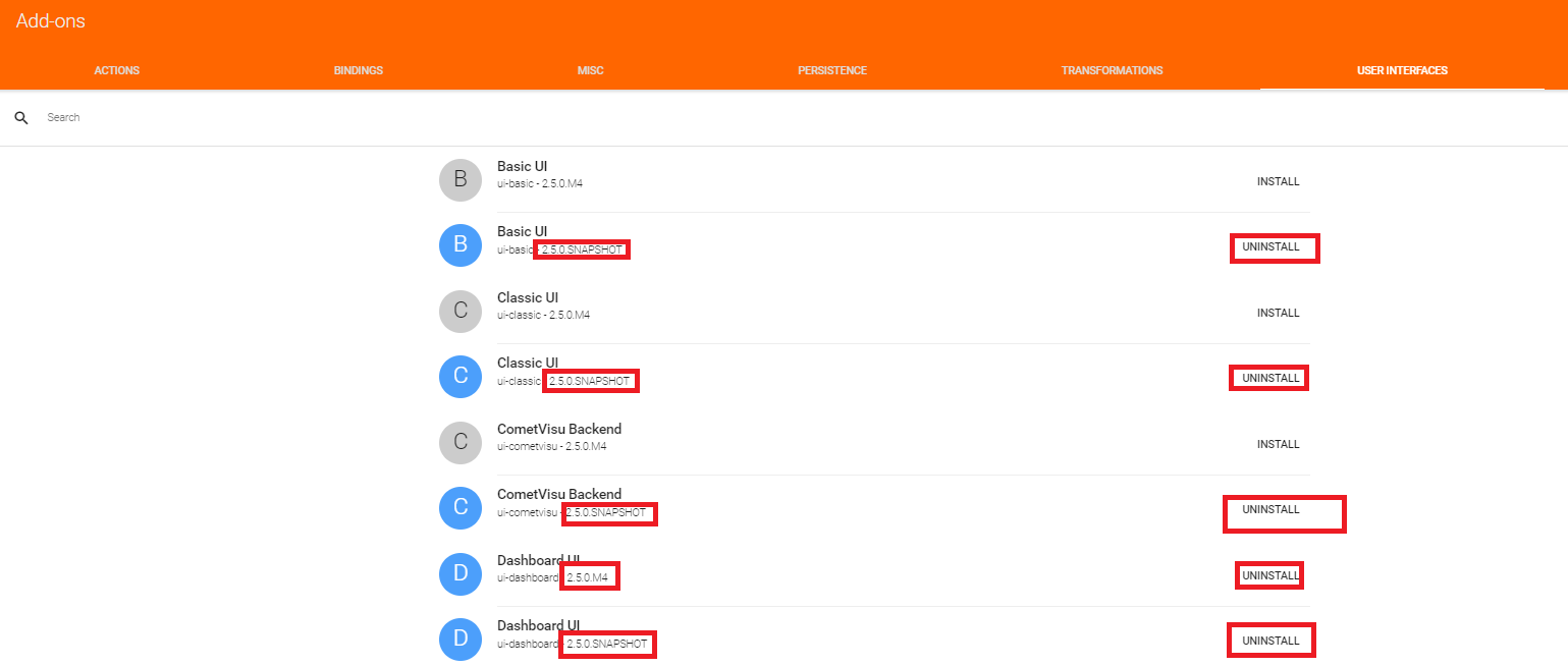

Then I installed the 2.5.0.M4 milestone. But now I can see a lot of snapshot references in Paper UI’s UI section:
Now I’m not sure if these are just junk references or something was left behine during the downgrade.
Can I sonehow make sure my system is not referencing anything from the snapshot build?
If yes, how can I clean these junks?
