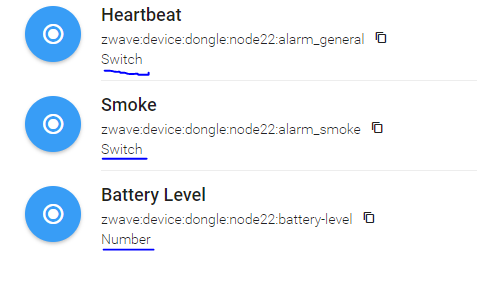

You are looking at the Thing, not the Item I suspect. When you look at the Thing that represents this sensor in PaperUI, it will tell you what type of Item you must use to link that channel to an Item.
I suspect you must use a Switch.
