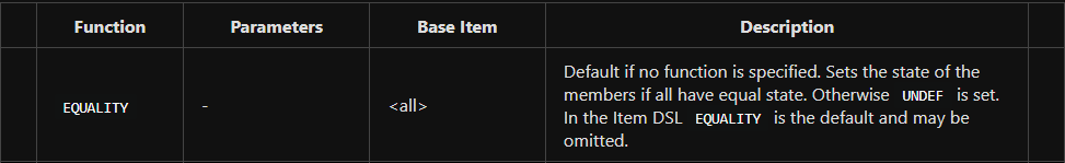

The outcome in log file of gThermostatMode.state = O if all heaters are OFF and UNDEF if any of them = !ON
The rule works and I could use this condition to switch ON ad OFF the group of thermostats, but my intention is to recognize real state/mode of the thermostat. How can I do that? I feel the group itself needs to be configured properly but I do not know how.
What are you expecting the Group state to be, exactly? You haven’t defined any aggregation function for your Group.
You can do stuff like count the number of members with state “ON”.
It gets trickier to count “ON” and “FULLPOWER”, because you can only set up one aggregation function for the Group.

While using a Group makes it easy to write rules to deal with all thermostats, and certainly easy to send the same command to all, I don’t think any aggregation function is much help to you here. What you want to do doesn’t depend on if 3 are ON and 1 in ECONOMY, so who cares.
