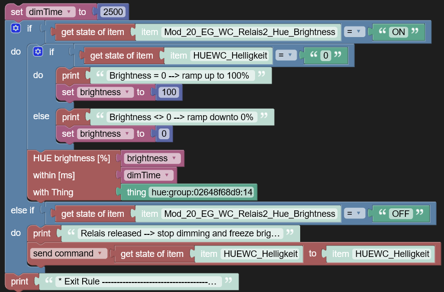

How to convert DSL in JavaScript for HUE-Dimmer via Blockly
First … thanks to @rlkoshak and @ysc (who answers to my “old” thread https://community.openhab.org/t/copy-of-blockly-rules/130953/5
I rewrote my Blockly component to the following (based on some examples I found in this forum … thx to the authors)

Also my Rule was modified to this to excute the new component only once
This all generates the following code which look good for me:
var dimTime, brightness;
var things = Java.type('org.openhab.core.model.script.actions.Things');
dimTime = 2500;
if (itemRegistry.getItem('Mod_20_EG_WC_Relais2_Hue_Brightness').getState() == 'ON') {
  if (itemRegistry.getItem('HUEWC_Helligkeit').getState() == '0') {
    print('Brightness = 0 --> ramp up to 100% ');
    brightness = 100;
  } else {
    print('Brightness <> 0 --> ramp downto 0%');
    brightness = 0;
  things.getActions('hue','hue:group:02648f68d9:14').fadingLightCommand('color', brightness, dimTime);
} else if (itemRegistry.getItem('Mod_20_EG_WC_Relais2_Hue_Brightness').getState() == 'OFF') {
  print('Relais released --> stop dimming and freeze brightness');
  events.sendCommand('HUEWC_Helligkeit', itemRegistry.getItem('HUEWC_Helligkeit').getState());
print('* Exit Rule ----------------------------------------');
But the call of this Rule will results again in:
==> openhab.log <==
2022-01-03 19:11:18.466 [ERROR] [e.automation.internal.RuleEngineImpl] - Failed to execute rule 'aaaa': Fail to execute action: 2
From my point of view (well, a less educated guess), the JS code looks good - I got back
But when I look to the action I’m not shure if the quotes at ‘hue’, the thing-ID ‘hue:group:02648f68d9:14’ and '‘color’ too are correct. Is there a significant difference between ’ and " ?
If yes it would be easy to change ‘hue’ to “hue”, but I don’t know how to change this for the thing-ID :unamused: … but maybe this is not the problem.
When we look at the error message … “fail to execute action: 2” … is here a usefull hind burried? My assumption is, that the fadingLightCommand has a problem. In the HUE Binding discription the parameters brightness and dimTime has special types … could this be a problem?
grafik
