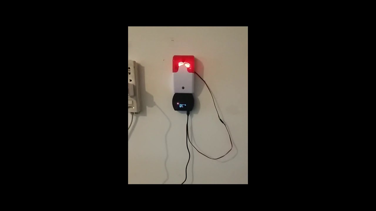

The IRTC051 in this video is more suitable for you. It does not require a network and can work independently
