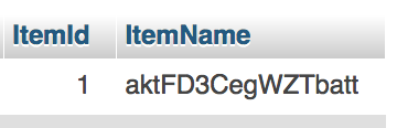

  2. There is one table called “Items” (in my graphical view of the phpMyAdmin UI it is the last table behind all “Item###” tables.
    This table contains the mapping of the item id which represents the number in the table count “Item1” to “Item###”.
Example from my database:
ItemId : “1” is mapped to ItemName : “aktFD3CegWZTbatt”

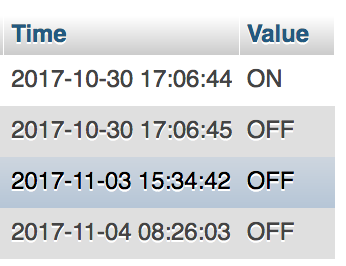

=> You find the data for “aktFD3CegWZTbatt” in table “Item1” :
The list of data is of course longer than this screenshot :wink:

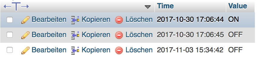

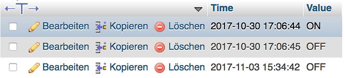

And now you are able to change, copy delete values from the “Item1” table
by clicking on the appropriate command in the GUI:
“Bearbeiten” = “Change” - “Kopieren” = “Copy” - “Löschen” = “Delete”

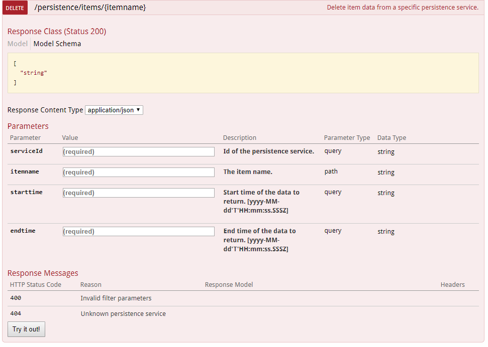

You could do this through the REST API.
This will work for all the Persistence databases, not just MariaDB/MySQL.
Hi Rich,
this looks interesting. I don’t know this GUI. How can I access it?
Install the REST API Docs add-on from the Misc tab of PaperUI.
