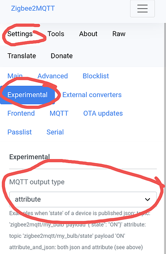

I also turned of the json mqtt message and use the “advanced” one which gives you sperate topics per payload.
