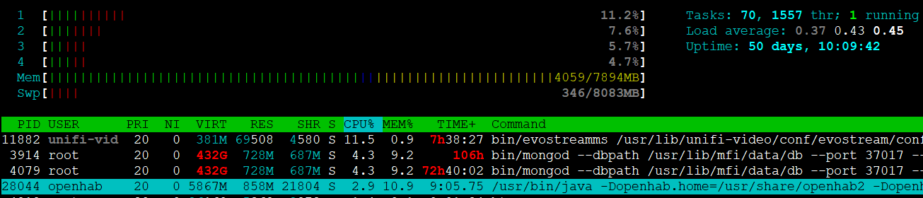

sorry to say, but it seems that there is something seriously wrong with your OH2 installation…
you need to go into debug mode and identify the issues (most likely caused by mis-configurations)
I have my system controlling 10+ bindings (KNX included) with uptime >1 month (due to frequent upgrades) and the cpu is:
