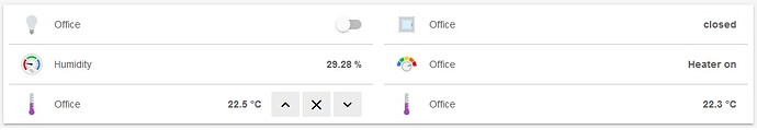

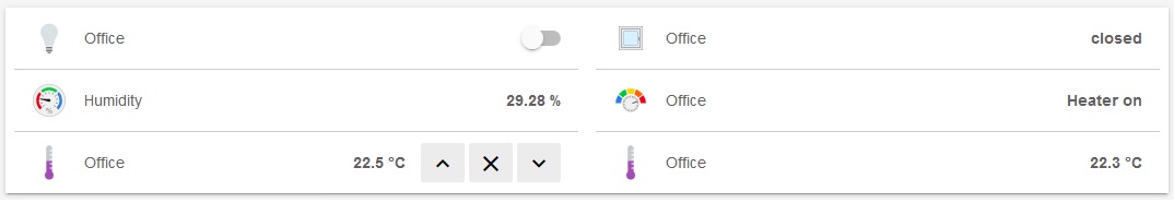

I used Rollershutter as a workaround.
Number 			SetTemp_FF_Office_internal 		"Office-Internal [%.1f °C]"     <temperature> 	(gThermostat_internal)         							{mqtt="<[mqttbroker:/bo19/sw0250_SetTemperature:state:default]"}
Rollershutter 	SetTemp_FF_Office 				"Office [%.1f °C]"             	<temperature> 	(FF_Office, gThermostat)    ["TargetTemperature"]       {mqtt="<[mqttbroker:/bo19/sw0250_SetTemperature:state:default]", autoupdate="false"} //autoupdate="false": to avoid displaying 0 and 100
Since Rollershutter states are 0 and 100 (UP and DOWN), I disabled the item ‘autoupdate’ and created another item that is only used in a rule to mimic the Setpoint functionality in Sitemap.

Openhab sent its ‘remoteSetTemperature’, then Thermostat mirror it to the actual ‘setTemperature’ value
