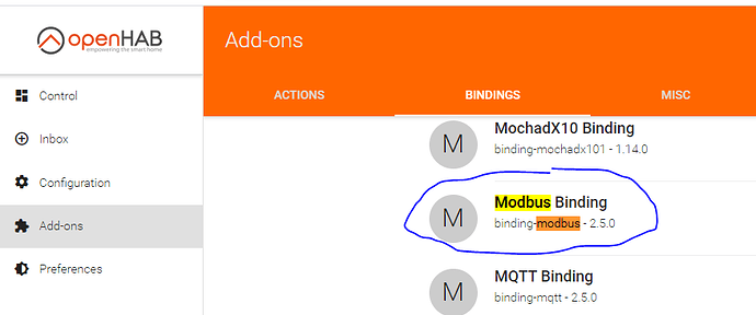

Where are you looking in PaperUI? I don’t think you will see manually installed add-ons listed under add-ons. But I think you should see it when you scan for new devices in the inbox or try to create a new Thing manually.

I would expect the binding here.
. I only find the 2.5 version
