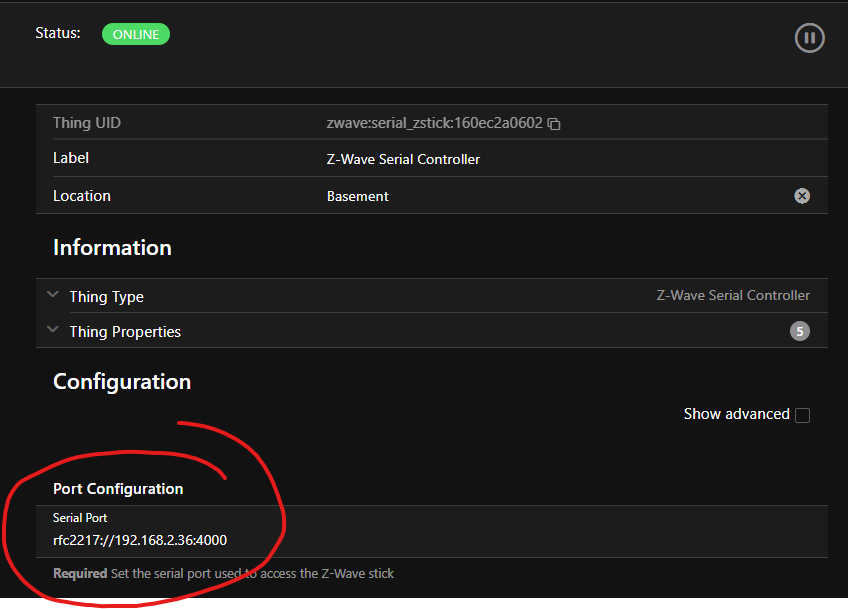

This appears 100% related to the device passthough to a proxmox LXC container. I ended up creating a second VM and adding the USB device to it and using ser2net to make the USB device available over ip via rfc2217. I initially made it accessible on the lxc container using socat, but to elimate another point of failure you can get zwave controller to connect directly to it.
On my VM that has the usb zwave dongle my ser2net.yaml has:
connection: &aeotecstick7
  accepter: telnet(rfc2217),tcp,4000
  enable: on
  options:
    banner: *banner
    kickolduser: true
    telnet-brk-on-sync: true
  connector: serialdev,
            /dev/ttyACM0,
            115200n81,local
and my zwave controller thing is configured as:
I might try elimating the dedicated VM for the dongle and see about intalling ser2net directly on the pve…
