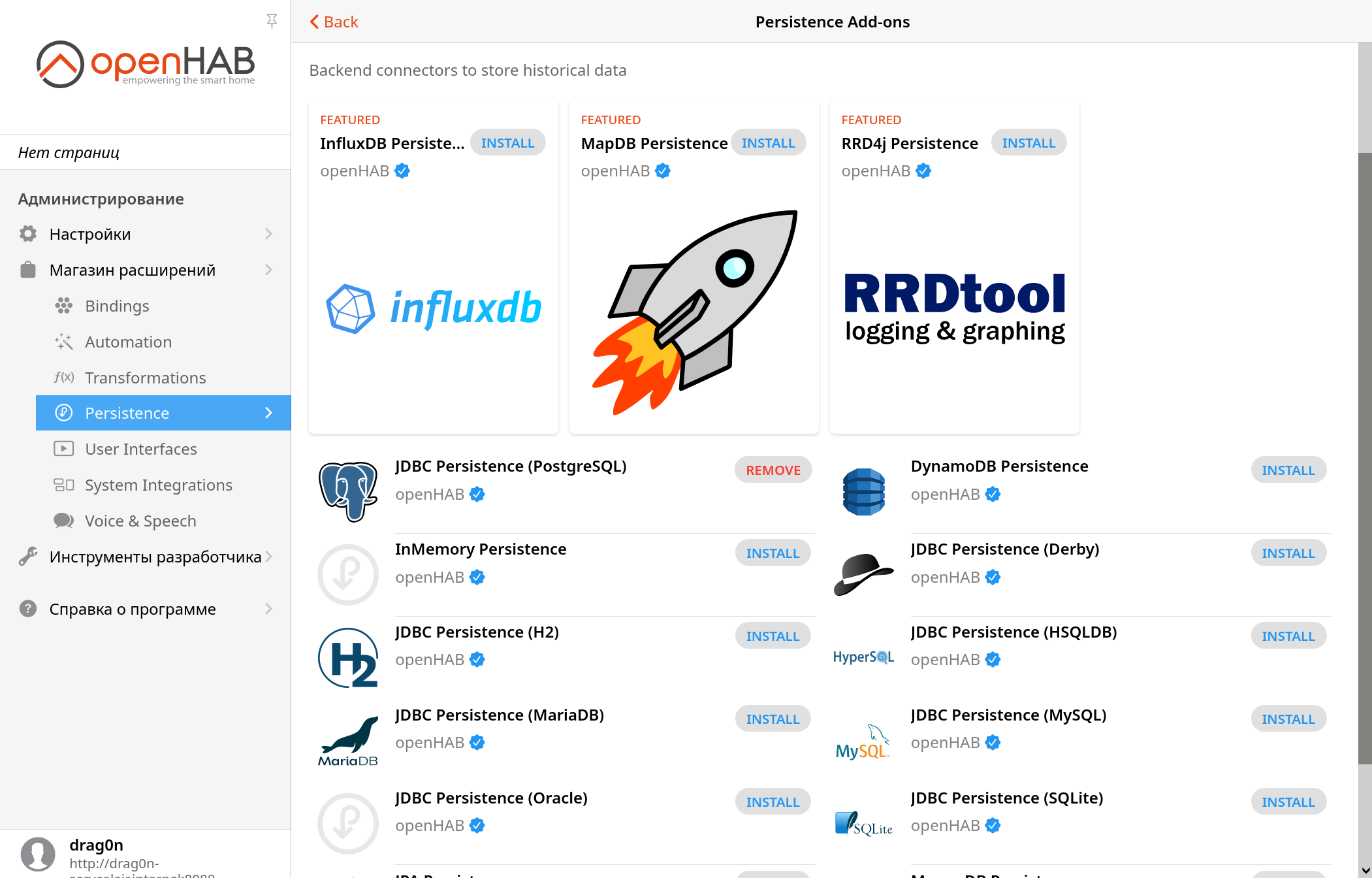

Done! For now web-interface will start successfully and become accessible at http://localhost:8080.
