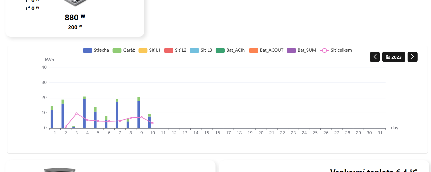

Is any chance how to show a chart directly on the overview page ?
component: oh-webframe-card
  src: http://192.168.6.42:8080/page/page_37558add8b

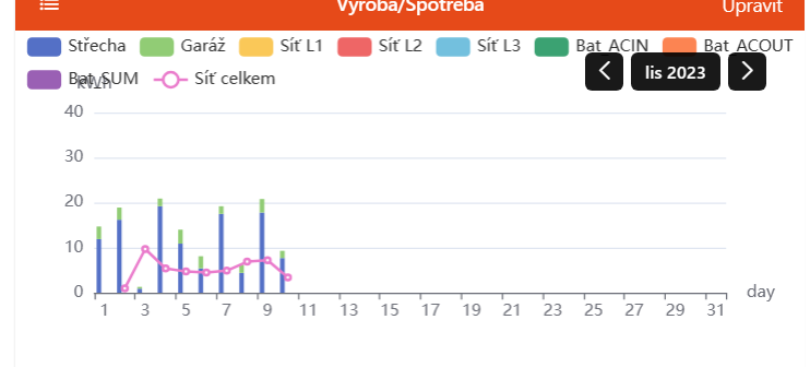

nice, bud he also added a upper menu :
maybe I must create a special widget
Nice!
I guess you will need to make a custom widget, please share the result :slight_smile:
fast first version, but must improve :
used a code from the page and did a copy into widget
Nice, can you please share code for this one?
Widget :

last two
                    chartType: month
is start of the code from the chart page. So here you will copy complete code of the chart page
