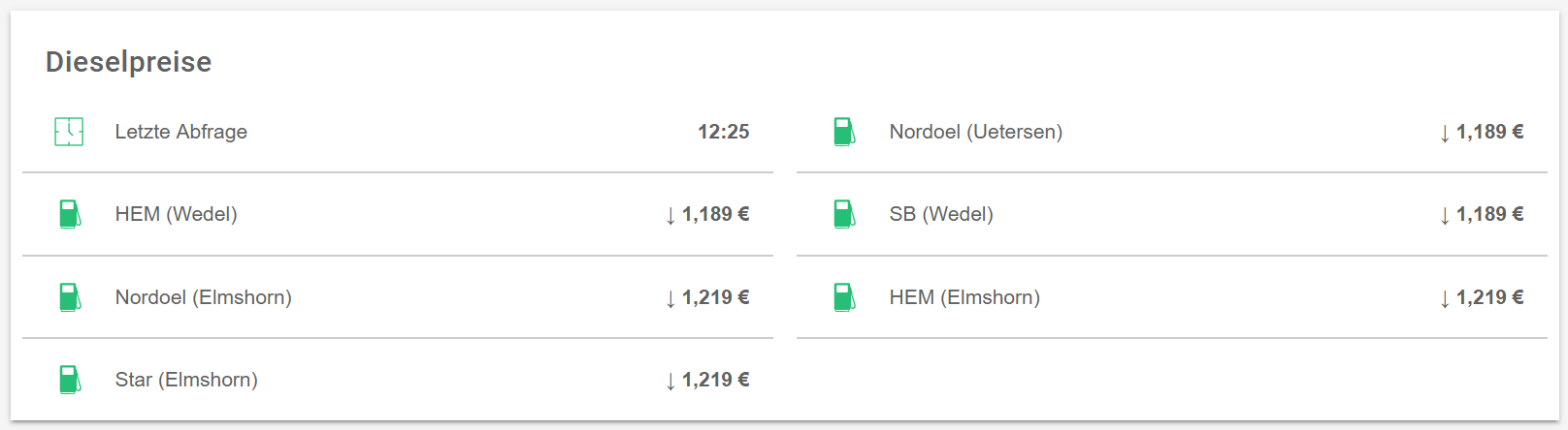

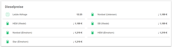

and last but not least the sitemap to display the items
sitemap smarthome label="Smart Home" {
    Text label="Information" icon="messageinfo" {
        Frame label="Dieselpreise" {
            Text item=iSL_OH_GasStationItems_LastUpdate label="Letzte Abfrage [%1$tH:%1$tM]" icon="timeclock"
            Text item=iSL_OH_GasStationItems_Display01
            Text item=iSL_OH_GasStationItems_Display02
            Text item=iSL_OH_GasStationItems_Display03
            Text item=iSL_OH_GasStationItems_Display04
            Text item=iSL_OH_GasStationItems_Display05
            Text item=iSL_OH_GasStationItems_Display06

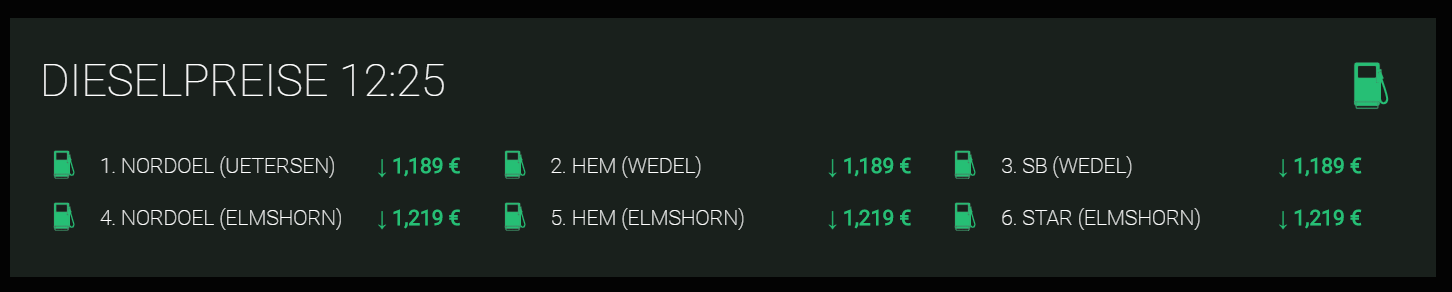

and my first try with habpanel based on the matrix theme.
<div class="section">
  <div class="sectionIconContainer">
    <div class="sectionIcon"><svg viewBox="0 0 361 361"><use xlink:href="/static/matrix-theme/knx-uf_icons.svg#scenegasstation"></use></svg></div>
  </div>
  <div class="title">Dieselpreise {{itemValue('iSL_OH_GasStationItems_LastUpdate') | date:'HH:mm'}}</div>
	<div class="controls">
		<div class="widget">
			<div class="icon off"><svg viewBox="0 0 361 361"><use xlink:href="/static/matrix-theme/knx-uf_icons.svg#scenegasstation"></use></svg></div>
			<div class="name">1. {{getItem('iSL_OH_GasStationItems_Display01').label}}</div>
			<div class="valueGroup"><div class="value">{{itemValue('iSL_OH_GasStationItems_Display01')}}</div></div>
		</div>
			<div class="name">2. {{getItem('iSL_OH_GasStationItems_Display02').label}}</div>
			<div class="valueGroup"><div class="value">{{itemValue('iSL_OH_GasStationItems_Display02')}}</div></div>
		</div>
			<div class="name">3. {{getItem('iSL_OH_GasStationItems_Display03').label}}</div>
			<div class="valueGroup"><div class="value">{{itemValue('iSL_OH_GasStationItems_Display03')}}</div></div>
		</div>
			<div class="name">4. {{getItem('iSL_OH_GasStationItems_Display04').label}}</div>
			<div class="valueGroup"><div class="value">{{itemValue('iSL_OH_GasStationItems_Display04')}}</div></div>
		</div>
			<div class="name">5. {{getItem('iSL_OH_GasStationItems_Display05').label}}</div>
			<div class="valueGroup"><div class="value">{{itemValue('iSL_OH_GasStationItems_Display05')}}</div></div>
		</div>
			<div class="name">6. {{getItem('iSL_OH_GasStationItems_Display06').label}}</div>
			<div class="valueGroup"><div class="value">{{itemValue('iSL_OH_GasStationItems_Display06')}}</div></div>
		</div>
	</div>
  </div>
