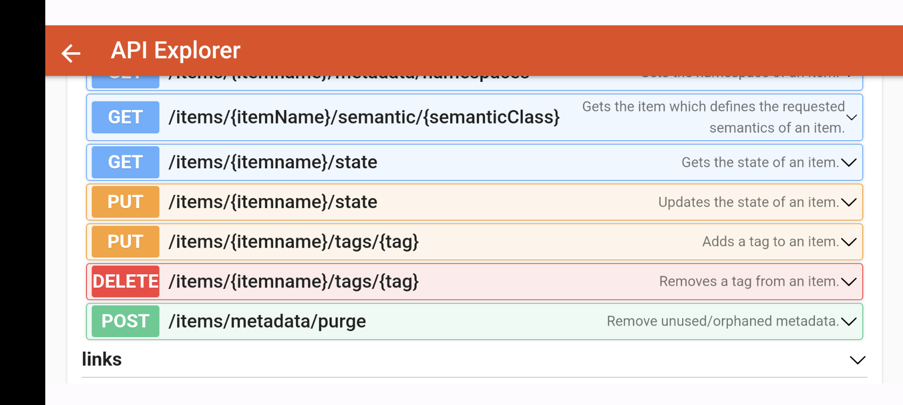

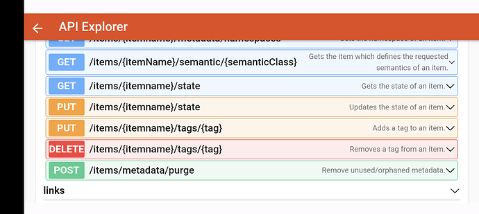

In MainUI open Developer Tools → API Explorer → items and find the row that shows how to get the state of the Item.
Thank you !!!
I tried this request before asking - but I received an http error 400.
So I thought that the URL was wrong …
