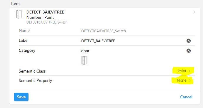

I cannot configure my sensor correctly
Semantic Class?
Semantic property?
Thing Type?
What profile to use?
I do not get a change of state

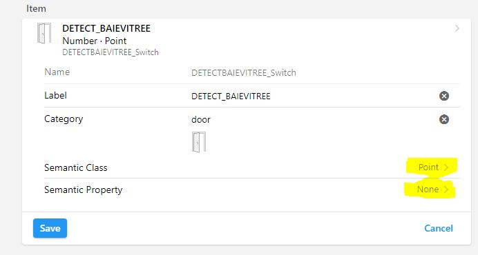

Hi guys,
Semantic Class?
Semantic property?
Thing Type?

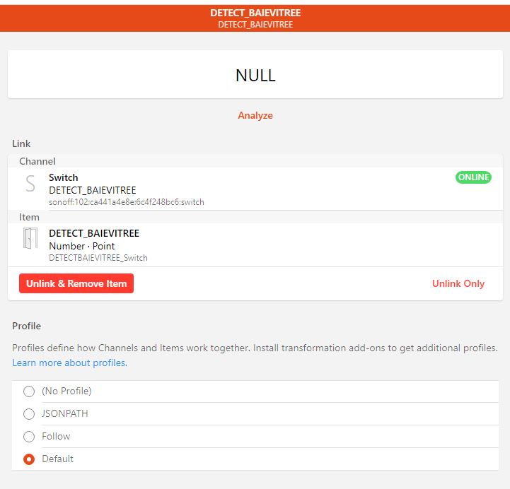

It looks like the Channel is a switch (?) while your item is a Number. That will not work.
You will need to have your item also being a Switch.

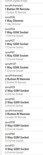

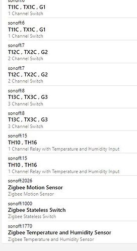

So I try to create it manually via the SONOFF BINDING

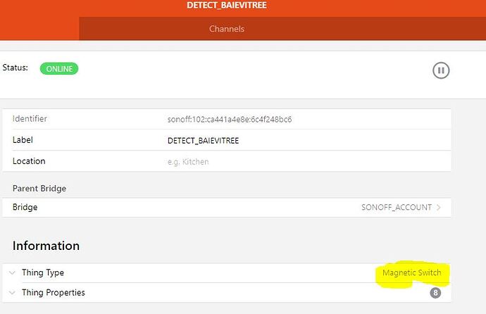

But what to choose?
Instinctively I chose “Magnetic Switch”
You could just change your existing number item to be a switch.
No need to create a new item for it.
Edit: take into account, i am not talking about semantic class/property, i am talking about the item type.
