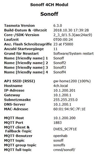

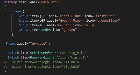

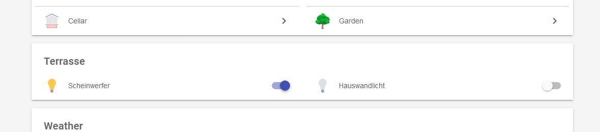

Same issue -strange problem. Openhabian running on RPI3. Trying to get a sonoff4ch running via mqtt. I can see and use the switch in the basicui but the sonoff4ch remains unswitched. Can you identify my mistake?
The Items file 4ch
the frontend

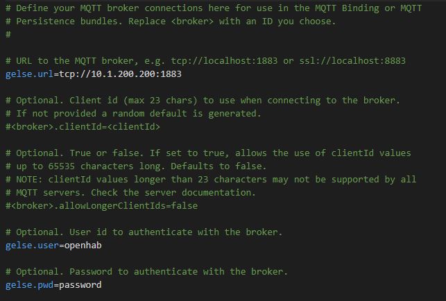

mqtt config:

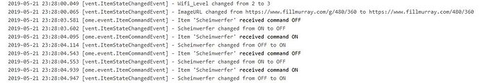

the log shows that the server receives the commands:
